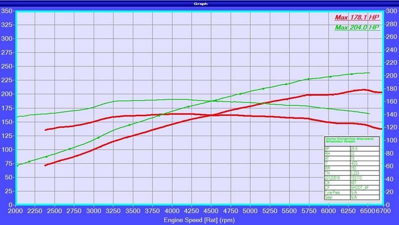

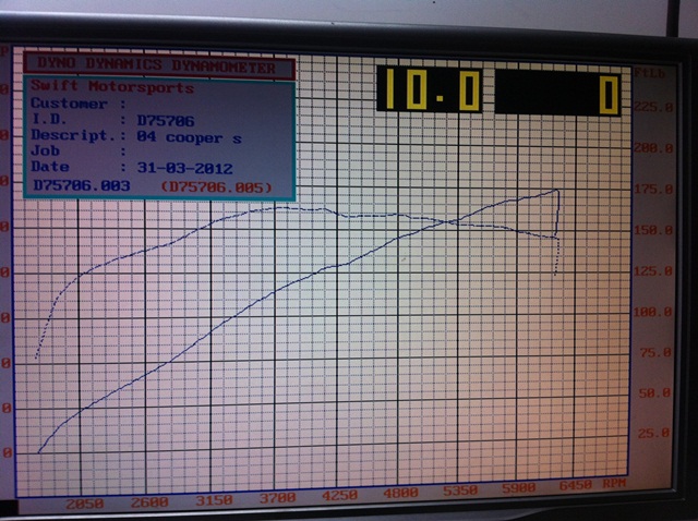

I have pretty much ever performance bolt on possible, minus a head and a cam. My car was tuned to 213 whp and 190 lbs and yes im running the valeo clutch.
It has 5k and so far no issue, it did slip a bit one i first got it, but im thinking thats normal durring the break in period. I babyed it for the first 1k after that point it works perfect.
First dyno picture is the 1st pull after the tune. 206/190
After tune 2nd dyno pull. Whp 213 and A/F ratio
http://youtu.be/AatGVGYwoek
3rd Pic is pre-tune with JCW map.
All dyno results pulls tune and JCW Map dyno results are on the Valeo clutch kit.
Also i have been told that
A. The Valeo will tolerate around 220WHP and
B. Its also how you drive it. Slip it like a noob and like any other clutch is goign to die.
So far no clurch rattle either. Hope this helps.
