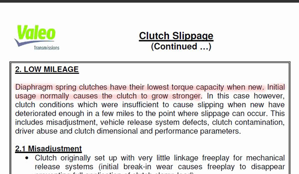

sounds like you glazed your clutch. If you never got all the air out of the lines you may not be able to fully release the clutch so your sorta slipping the clutch everytime you shift or press and hold the clutch pedal.
I was able to bleed the slave and the clutch pedal feel is a night and day difference. I didn't have the special tool to compress the slave but I was able to do it by threading a 1" tow strap through the slave mounting holes. About 440 miles have been driven (although more than half is highway) and I am still experiencing the occassional shudder at take off. I finally stepped on it today all the way to redline and the clutch slipped right at 5K RPM then it grabbed all the way to 7K RPM. I guess I will give it a couple hundred miles of extra break-in to see what happens. If the symptoms persist I will have to say that this would be my second and last MINI. I will trade it in for maybe an M3. The sad thing is I really like my mini but I don't think I want to put out $2100 for a performance clutch and labor. I regret not going that route initially.
