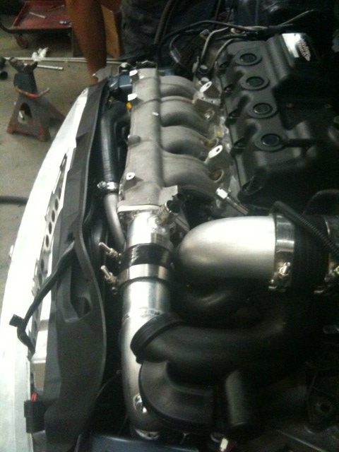

should have added this.............................................. ..........................
Attached Thumbnails Is it possible to make 400+whp on a Supercharger?-rotrex-400.jpg

BTw - I want this !!!!!!!!!!!

Originally Posted by Hippie
Jan - you should make sure Ian reads this
that you can't turn a high hp Mini?
Originally Posted by COOUUPER S
Love ittttt!!!!! Tell me its stock. Supercharger.
how can you make 400hp with a stock supercharger?
it could easily work on the stock charger but you would still have to give up your a/c........ Graham from GRS already makes a front mount for the stock supercharger

GRS's front mount IMHO is not all that thought out. They are using the stock "bullhorns" for the stock I/C and droping the piping down in front of the scoop/radiator. A good perk of what your setup shows is that it ditches the "bullhorns"(and all those 90 degree bends) for a freer flowing design, and proper plumbing. Also with your setup you could do a larger intake manifold or atleast one with longer runners (longer runner length increases TQ), there is plenty of space going up where the top mount crap was. Another downside to the GRS FMIC is the I/C core is F****N HUGE, they even admit to loosing quite a bit of boost, and taking longer than desired to build pressure in that thing.
It would realy be nice if sombody would design a S/C outlet and pipe kit for a front mount and also offer multiple sizes of cores to suit the needs of the car. (Hint,Hint Jan )
I am realy impressed by what I have seen from the pics so far, and I am hoping that it is the big ole TVS 1300 siting nicely under that manifold.
Oh a couple posts back we made history (I think), Thumper actually gave credit to Jans work, and agreed with him. Never saw that one coming.

I wish I could fit a 1320TVS down there but it just won't go
what's on the car is a 30-94 Rotrex which has a mass flow rate of .37kg/s
with longboards car we used the 30-74 which has a mass flow rate of .28kg/s
it made 350whp
as for your other question, making a fmic isn't an issue the way you describe, it's finding enough paying customers to make it........lol
