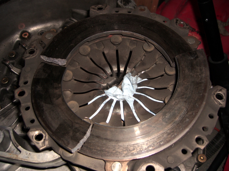

After having the car towed home I began the slow dance of running back and forth from poking under the bonnet and consulting my favorite Mini Cooper Forum. After a day of doing this I can now provide the following diagnosis:
1) Front rotors are at or below minimum thickness, pads not far behind,
2) the driver's side steering rack gaiter was disconnected and grease flung everywhere (thank you N+B),
3) there is a power steering leak at the return hose,
4) there is a coolant leak at the thermostat housing,
5) the radiator support stucture is cracked at two or three different places,
6) the OEM (Luk) pressure plate was broken into two pieces,
7) the clutch disc was getting thin and the flywheel was due for replacement,

the valeo from my understanding IS the stock clutch.,. just doesn't have bmw written on the box and it costs a whole lot les because of that. the stock flywheel is the valeo dual mass, but you can get a valeo single mass if you want.
Luk and Sachs co-manufacture the OEM Clutch and flywheel assembly. The Valeo kit is a conversion kit from a dual mass to a single mass flywheel. Valeo is not associated with Luk or Sachs in any way.
