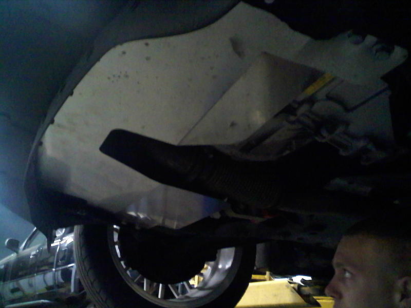

so i had it up last night and right away i noticed it was the skid plate... i installed it in such a hurry that if you would believe, i mounted it upside down! so it was hitting the trans and oil pan... wow what a simple fix that was.. 100% better and rechecked for any tube leaks and it was all good. reset my ecu and got my snap back thank you to any one who helped

grrrreat to hear! the entire drive back i was so happy.. and once the skid plate is on correctly there was no vibration at all... it actually looks pretty nice (when its on correctly).. last time i try to do any mods right before work!

does your inner cooler cause a lot of vibration?-0309002118.jpgbefore... notice the fins hitting the gear box and oil case
does your inner cooler cause a lot of vibration?-0309002152.jpgafter... fins facing down .. never do mods in a hurry! ...little rockstar touch to it

Nice! Did the vibrations go away and the Rockstar sticker is a nice touch though no one is ever going to see it.

You defidently have that "I can't believe I did that" look in your eye in the before pic. I know that look well.

oh ya ! the vibration was the skid plate hitting gear box and oil case, not good things.. when installed correctly ( ) they do not touch anything other then the frame it bolts on to.. i know the look of... ummmmmm i think its upside down i'm very pleased with the end result
