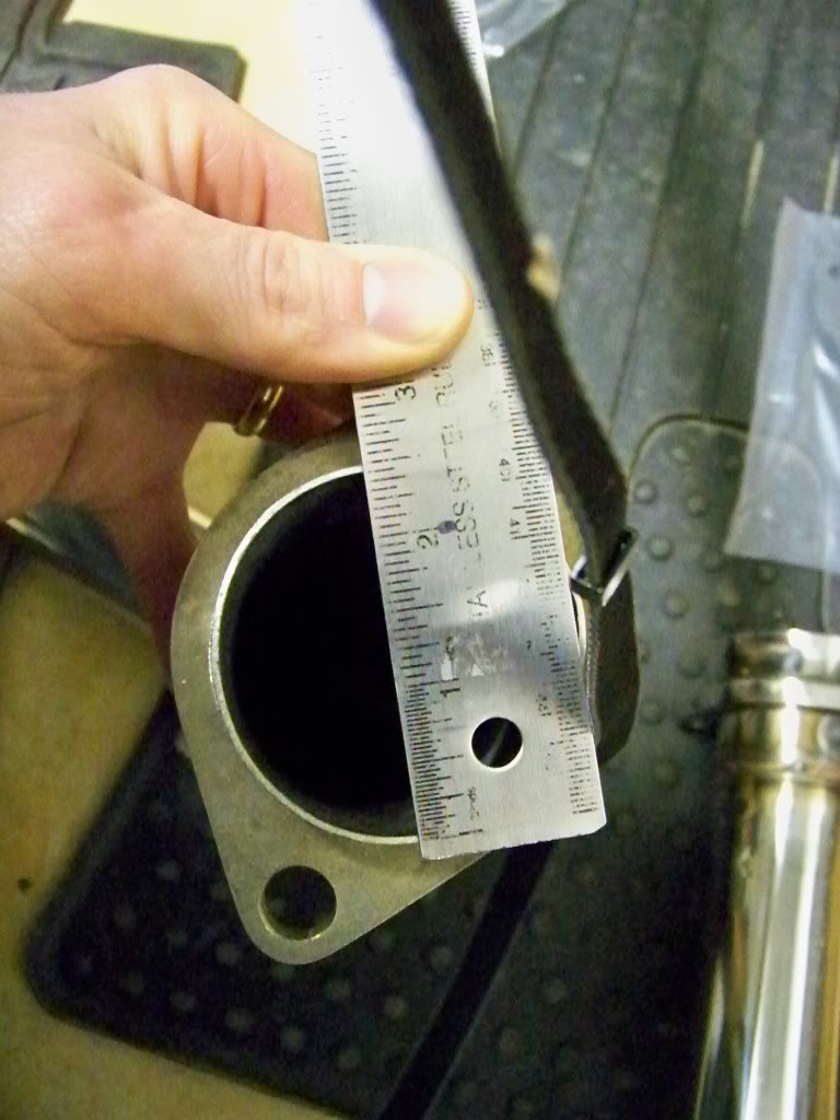

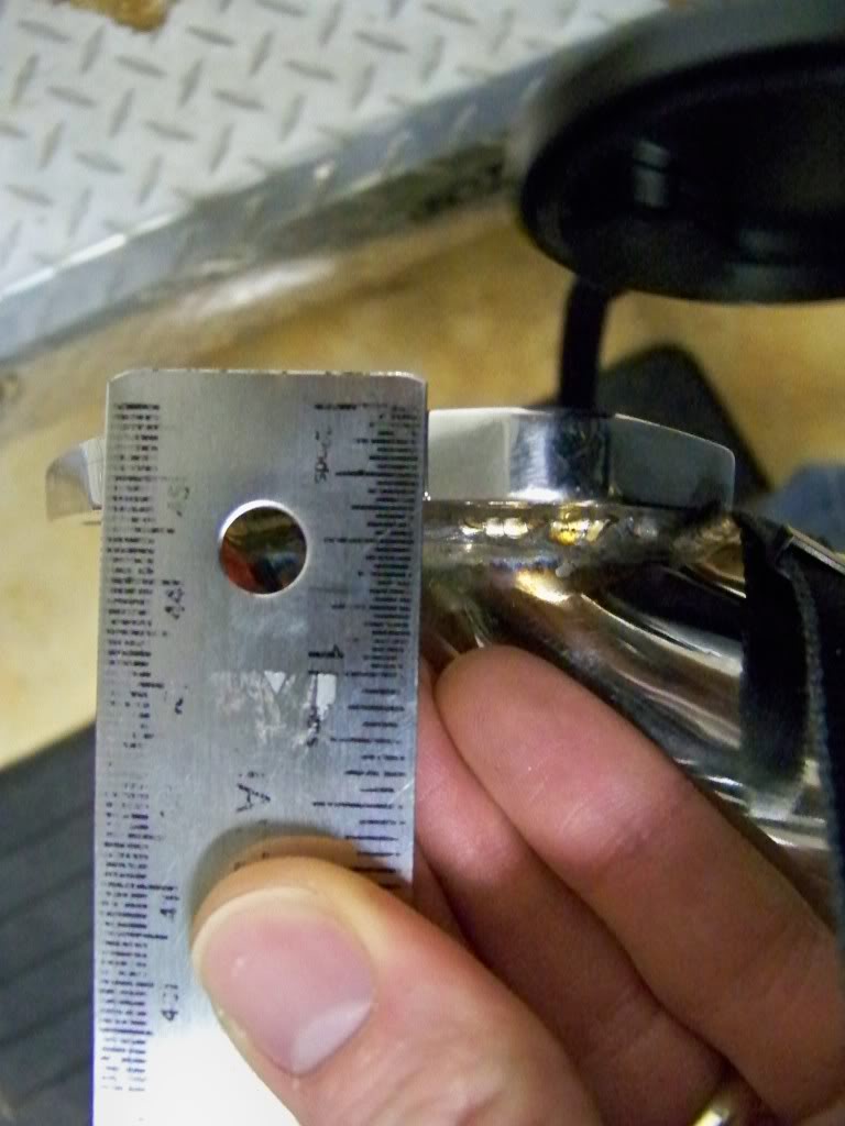

The 1.5mm figure was just a wild guess, seems I got pretty close
I did the same calculations and came up with about the same thing, but didnt take in account the flange and shipping materials. I hope i get both the downpipe and midpipe like the pictures show.
Is 1.5mm thick enough for a downpipe? My WMW cat-back appears to be 1.5mm but a lot heavier.

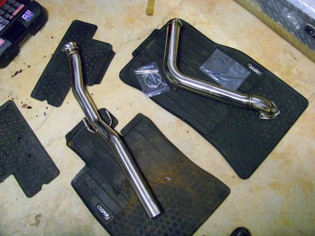

Yes the pipe thickness is as measurable as 1.5mm. it appears to be the same thickness as my WMW Catback exhaust but I do have to say the OBX is not quite as high a quality as my $699 catback exhaust; but its close. Also the box was hardely near the 12 lbs UPS had on record. I'd say the box weighted closer to 20 pounds; so the seller screwed the shipping company for about 8 pounds. I hope thats all the seller screwed...
The OBX midpipe was stated to be 2-1/4" OD on the ebay description, but it actually turned out to be slightly larger at 2-3/8" OD and 2-1/4" ID. To get the OBX to bolt up to my WMW Cat-Back exhaust, well; my cat-back came with an adapter specific for the VBand to adapt to the stock midpipe which I'm not exactly sure if anyone else has really seen before since it looks a little custom. This golden piece is gonna make my install a very easytransition from the OBX to the WMW Catback; All I think I need to do is cut this adaptor piece by about 3 inches along with make an aditional purchase: I just bought this 2.5" Lap joint Band-Clamp from Jeggs so that I can fit the OBX Midpipe to the WMW exhaust adapter for like $12 shipped:
http://www.jegs.com/i/JEGS/555/30732...oductId=753274#
I did a bunch of online reasearch and found that Jeggs appeared to be the only retailer who sells a 2-3/8" to 2-1/2" lap band clamp. There was another company; Walker which is larger, and then theres Summit Racing with in-between sizes without descriptions. I feel this Jeggs piece will work for me.
What this will do: I'll be able to slide the OBX midpipe 2-3/8" OD snuggly into the 2.5" OD (2-3/8 ID) WMW Catback pipe and then lock it all together with the Jeggs SS Lap band clamp. I'm also using a second lap band clamp I got with the WMW exhaust which secures the read pipe with the muffler.
This is good for me but likely harder for people with stock exhaust measuring 55mm (Which is 2-5/32 or 2.16"). OBX does not include anything past the midpipe for bolting to the stock cat-back so you'll likely need to cut, buy, and weld a few inexpensive pieces. I'll know more for sure when I pull the stock exhaust off my car this weekend; I'll take some pictures and show what does and doesnt line up correctly.
I've really lucked out. Since I bought the catback exhaust barely used my grand total so far has been less than half-a-grand for a SS decatted turbo back system. Not bad so far; we'll see how install and performace goes this weekend!

I believe that system is the one OBX copied minus the resonator. My guess is the 3rd pipe back on the supersprint cat-back has the means to clamp onto the second pipe.
I did measure the flasness of the DP flange, and its about 99% flat and nothing my Black and Decker belt sander cant turn to perfectly flat. Also OBX came with not one but two turbo to DP gaskets - although they dont look too high a temperature rating. I'm going to try and use the stock gasket which is only $10 if I need to replace.
The next thing I'm scared about is having a complete exhaust with only pipe and a muffler. No resonators will probably make it sound anoying. We'll see.

The welds on this OBX equipment look alright. I do wish they welded the pipe inside of the turbo flange where all the exhaust first hits upon exiting the turbo. I've been thinking about getting that taken care of but didnt want to start any bad press for the OBX.

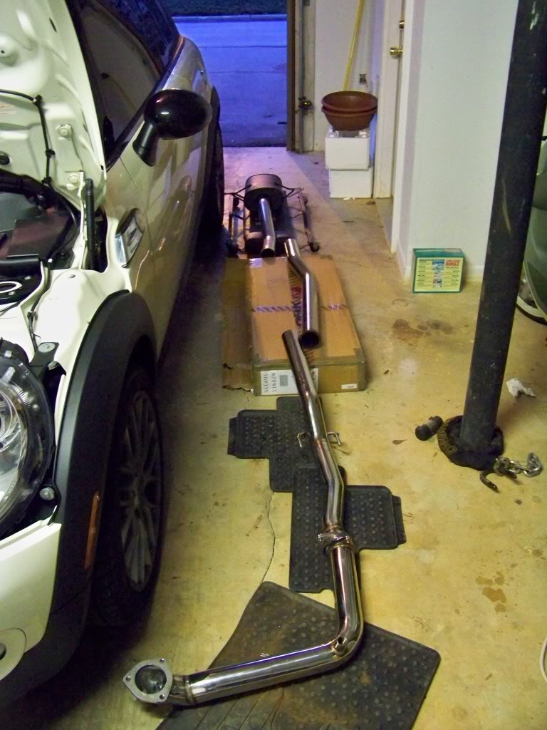

YEAY!!!! Its fully installed!!!!
This evening I got my replacement band clamp and went right to work. I took off the old exhaust from the turbo back. No surprises taking the stock stuff off. I laid the stock exhaust next to the OBX/WMW pieces and realized I had a very minor issue. The OBX/WMW exhaust combination is about 8 inches shorter than the stock exhaust. Luckily I have an exhaust shop just right down the street - I was able to get a free 8 inches of 2.5" Mild steel pipe cut and welded to the adaptor between the WMW and OBX. This adaptor piece I believe was included with the WMW cat back but Im not certain. Its a piece of mild steel 2.5" pipe with a 3" v-band welded on the end - a perfectly straight piece. The WMW bolts to the v-band and the OBX midpipe slides in and locks in place with the Jegs band clamp.
To get the stock exhaust off, I had to remove a metal plate held up by 6x10mm bolts right in the middle of the car. i have no idea what this plate does, but it wont go back on with the aftermarket exhaust due to clearance. No big deal do me. i put the 10mm bolts back up but left the plate off the car.
So with my welded 8" extension piece I was able to complete the install. I first started with bolting up the downpipe, O2 sensors, and factory heat shields. The alignment of the OBX pieces are about 97% perfect. The only minor bump was with the stock heat shield where the O2 sticks out the top. I just man-handeled the heat shield until it moved about 1/8 an inch. In doing so I could not re-attacd one of the 10mm bolts for the heat shield just behind the radiator; but I expect nothing to come of it and just left it without a bolt. The only other thing with the DP is it doesnt use the lower mount like some companies. I think Alta was having problems with the mount cracking anyways. no biggie.
The rest of the stuff bolted right up - OBX midpipe popped into the stock exhaust hangers with no hickups. The joint between the downpipe and midpipe turned out to be satisfactory with everything included from the ebay purchase. The back of the midpipe accepted my welded adaptor, and then the WMW exhaust bolted right up the the adapter's v-band flange with a v-band clamp. After the first heat cycle I had to adjust the exhaust because it had slightly expanded past the bumper. It grew about 1 inch in length when it got hot.
Fitment was very very good, and in a few weeks I'll probably go get 1 foot of 2.5" stainless and a new ss v-band flange to get rid of the temporary mild steel pieces I used for the adapter. For now its good to drive.
I really really doubt this system will fit the stock Mini exhaust. If I had to guess I'd say the best thing you can try is the OBX Cat-Back exhaust which is available from the same ebay seller. For $275 it just might be worth it. The DP costed $175 shipped; so you can get a full OBX turbo back exhaust for $450 shipped. Or you can do what I did and collaborate efforts on a middle connecting piece for your application.
The drive. First thing I noticed was NOISE. The exhaust is definately noisy enough to overpower a blasting radio. Having no cat or resonators does not make for a very peacefull ride. Armed with only the WMW mufler its about 4 times louder than stock. The sound quality instantly reminded me of a Subaru WRX; perhaps just slightly raspier in fact. Its definately no Honda Civic but dont expect your neighbors to be very impressed. I'd say the exhaust sounds very similar to this clip of an Alta 3" full exhaust:
