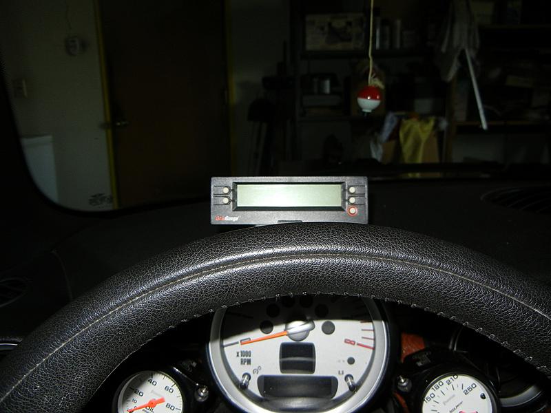

After trying 3 other locations, here's where I finally ended up. Craven modified their dual gauge mount for me so it would take the SG mounting arm mounted vertically. I shortened it 1" to get it out of my straight ahead view, but still be able to see it. This time it's staying put! LoL
BTW, here's an old race driver's trick. Note my OP/WT gauges look all cockeyed. That's so when they're in their normal operating range the needles point straight up. You don't have to stare at them to tell something ain't right.
