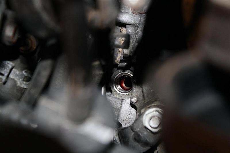

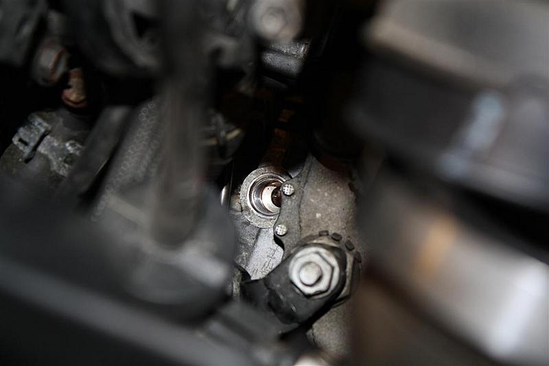

Pics, as promised. I circled the fill hole in the 2nd pic in case it's hard to spot. Do I have the right one? I hope so!

Old Jul 19, 2010 | 02:38 PM
  #57
fishbone's Avatar
fishbone
Joined: Sep 2008
Posts: 358
From: TX

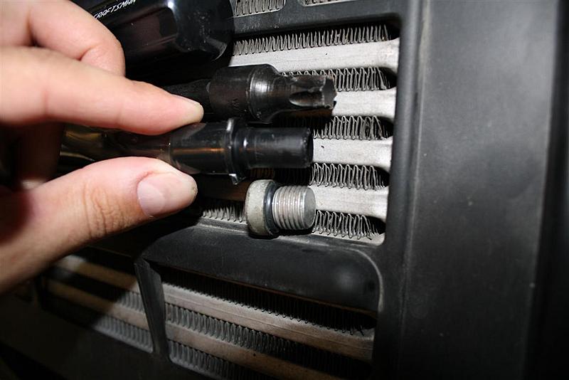

Here's another pic showing the T-55 torx I used, how the fill bolt looks and next to that funnel hose. Notice that it is an exact, perfect fit for the hole
Old Jul 20, 2010 | 09:59 AM
  #58
fishbone's Avatar
fishbone
Joined: Sep 2008
Posts: 358
From: TX
So, am I looking at the right bolt? :D

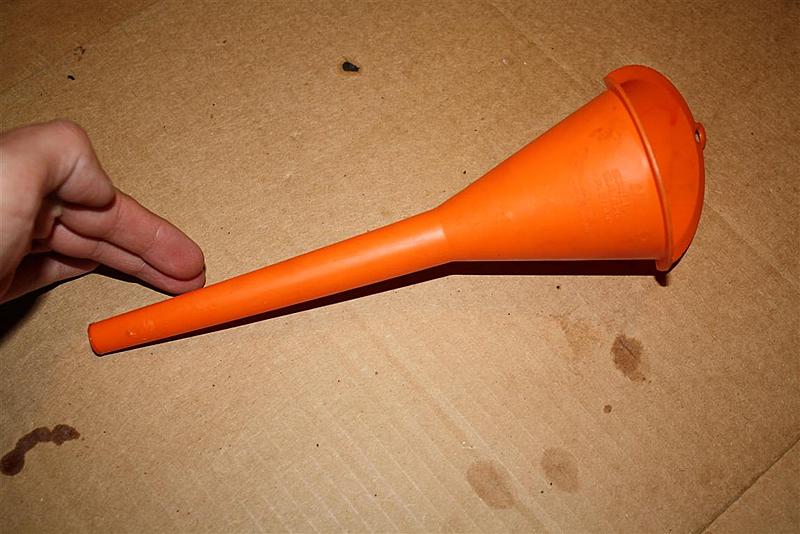

Finally got a chance to do the ATF drain today. It's midnight so I'll post pics some other time, as soon as I get a chance.
First off, the funnel in the pic above did not work. I now know why the dealer tool is required. What they have is just a screw-on head attached to a clear plastic tube. The plug has a very small hole through which the ATF flows, as such it goes in WAY slow. If there is ANY room around the hole, the ATF will flow out and you will make a mess. I got lucky with a straight plastic funnel with a long neck, it was just about the same size as the hole, so I shoved it in there (it was so tight, I could have actually screwed it in) and filled it right up.
The instructions to keep the car level are bullcrap. If you do that, you will only get 2 quarts out at most. The best thing to do is jack the front as high as you can. The drain hole is towards the rear of the car so the higher the incline, the more ATF you will get out. The car only needs to stay perfectly level if you are checking the ATF level and making sure it is not overfilled or underfilled. If you have no evidence of leaks anywhere around the pan and plug, then you should by all means have the correct amount of ATF that should be in there from factory. One could always check the level after a drain and fill.

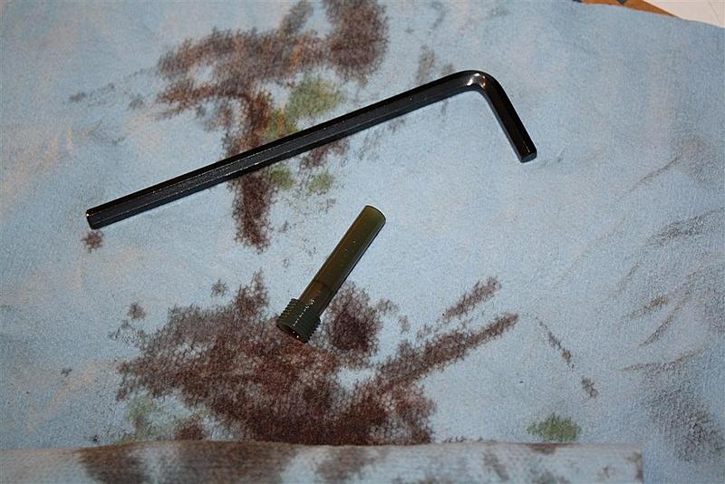

Unbolt the ATF drain plug using an Allen 5. When I did this, with the car cold, I got just under a quart out. My car was NOT jacked up, but it was on a very slight incline (just enough to get the bubble to go half over the mark on a level). Be patient for the ATF to drain.
Use the same Allen key, with the long end, to take the stand pipe out. It is in the same hole as the drain plug. The stand pipe is plastic. Be gentle. Don't force the key in, take your time and make sure you get it right.

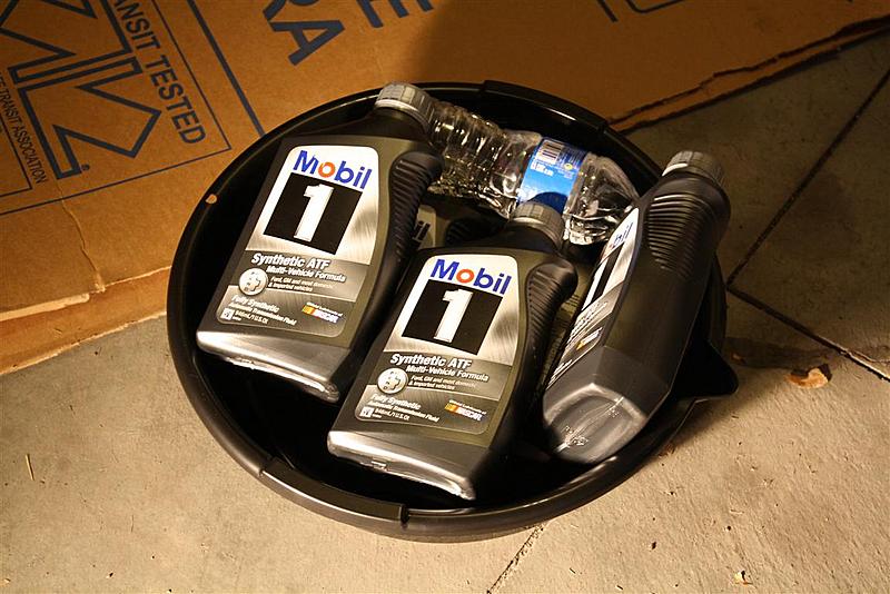

1. (pic1)Choose your ATF and get a shallow drain pan

3. (pic3)The location of the fill plug is pictured here

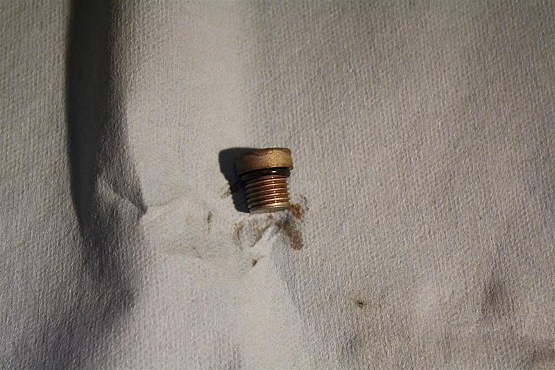

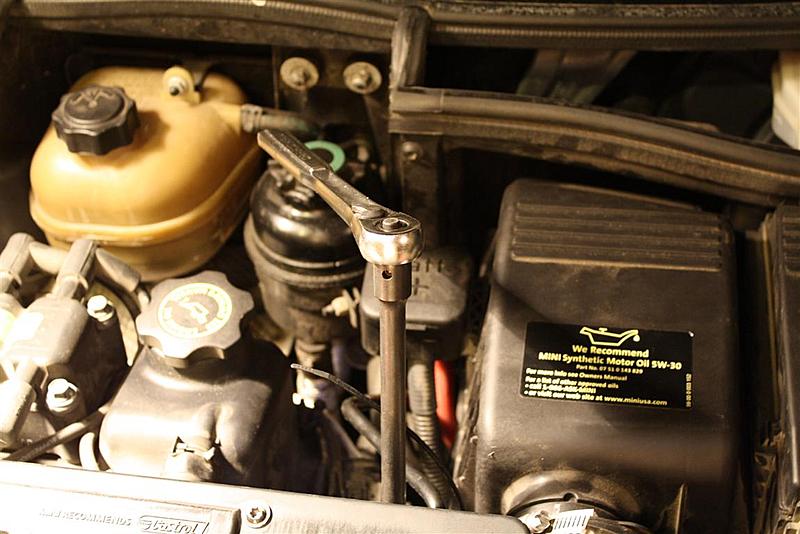

4. (pic4)Get the Torx and the extensions attached
5. (pic5)If your ratched looks like this, you are golden
6. Slide your hand through deep in there on the right side of the intake hose and take the bolt out. Better yet, if you have a strong magnet, stick it on the torx bit
7. (pic7)This is what the fill bolt looks like

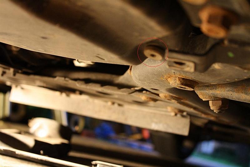

8. (pic8)Another view of the fill plug
9. Get under the car, remove the plastic undertray

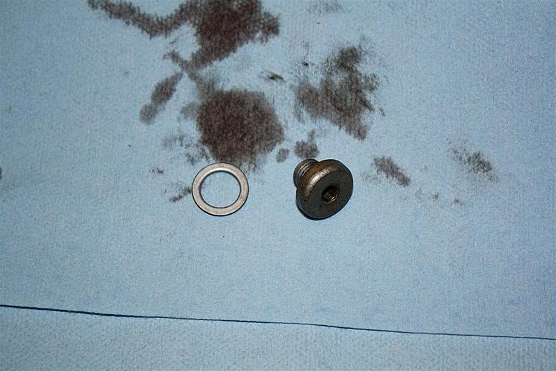

10. (pic9)You should now be in clear view of the drain plug, circled red in the picture. Stick the Allen key on it and unscrew it
11. Let the ATF drain
12. Once done draining, stick the long end of the Allen key gently until it catches the stand pipe, unscrew it and take it out. Careful, a bunch more ATF will gush out. Important! Measure exactly how much ATF you got out. In my case, I got a total of 2.5 quarts out. What comes out must go in, in order to maintain proper ATF level from factory. If you suspect you have had a leak or want to make 100% sure you have the proper ATF level, then keep reading, this will be in the last post.
13. (pic10)Picture of the drain bolt with the crush washer. After doing the last drain/fill, replace this for peace of mind and assurance you will not develop an ATF leak. Your dealer should stock it, if not the size in milimeters is 17X12X2.

12.(pic11) Picture of the stand pipe. It is plastic. Be gentle. Do not cross-thread or overtorque. Just get it hand-tight when putting it back on, it's not like it's going anywhere.

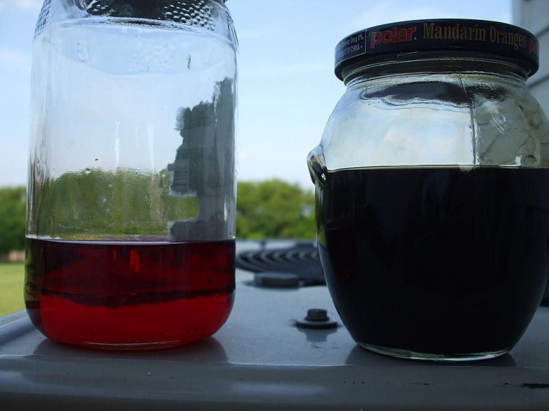

13.(pic12) If you want to get an idea what the ATF looked like at 70K miles versus new, here is a picture for reference. (this picture was taken of the ATF that came out of my Subaru at 45K miles but the color is exactly the same).
14.(pic13) Just because I'm super nice an thorough, here is a picture of the funnel that worked for me. I got it at Walmart and the reason it was ideal was because it was very tight against the fill plug. If there is ANY room around it, you will get ATF to seep out instead of go in the tranny and you will make a mess. The funnel is called Spill Saver by FloTool. Shove it in there and then rotate it about half turn.

Originally Posted by fishbone
If you want to re-check you have the proper ATF level:
-the car needs to be sitting perfectly flat. You CAN do this without raising it at all, especially if you have a shallow drain pan that you can shove under there
-start the car, make sure it is in Park!
-ATF needs to be between 35*C and 45*C, which is 95-113*F. This also applies to the one you will pour in. Yes, you have to warm it up, just let it sit in hot water. When the ATF is cold, the level drops. Too hot and the level will be at full max. It needs to sit somewhere in between on the dipstick that doesn't exist on the Mini tranny. The tranny instead uses the internal standpipe for this procedure instead. I think you are beginning to understand where all this is going. Without the proper diagnostic tool to measure ATF temp, it is a crapshoot but nobody says you can't be creative! Grab a kitchen thermometer, you could use it in the next step
-unscrew the drain bolt. Does ATF come out?
--If not, then pour in the warm ATF until it starts coming out. When it does, stick the thermometer and take a reading. If it is WAY hotter than 113 or WAY cooler than 95, you might want to either let the car cool, or idle longer. Once it starts pouring, stop filling it in and cycle through all the gear positions (go P,R,D and then back to P) for at least 2 seconds in each position. Add more ATF until it starts coming out again and you are done!
--If ATF does start coming out, double-check to make absolutely sure the car is sitting level and take a temp reading like I suggested above. I would let it drain until it stops because you may have an overflowed transmission and just follow the steps above when filling it back up.
Just remember, the temperature is sort of important because you are aiming roughly for the middle of the dipstick (standpipe).
This procedure sounds exactly like how I do ATF drain/refills on my VW New Beetle, which has the notoriously unreliable 01M 4sp auto ... also claimed to have "lifetime" fluid by VW.
To check the temp, all you need is an accurate infrared thermometer or a traditional flat, plastic one that can be taped onto the oil pan. I use a Suunto. On my Bug, it usually takes about 5-7 minutes to reach the specified range. I shift through all the gears first, put in N or P, then check the level.
BTW, I've done 3 drain/refills for my Bug at every 50k. Each time only 50% of the fluid is drained, so there's always old ATF in the tranny. All I can say is it still works at 174k. In November '09, I did a 2k trip to Oregon and just did a 1k trip to Yosemite last week. It's seen everything from 40-100*F+ dessert heat to 8000 ft elevation climb. Here's hoping it'll run to 300k!

Glad to help! IMHO I would do at least 2 drain/fills, if not 3. If you do one, you will have about 40% new fluid. If you do 2, you will have about 64% new fluid. The 3rd one will seal the deal
All that remains now is for us to find a source for those crush washers.
