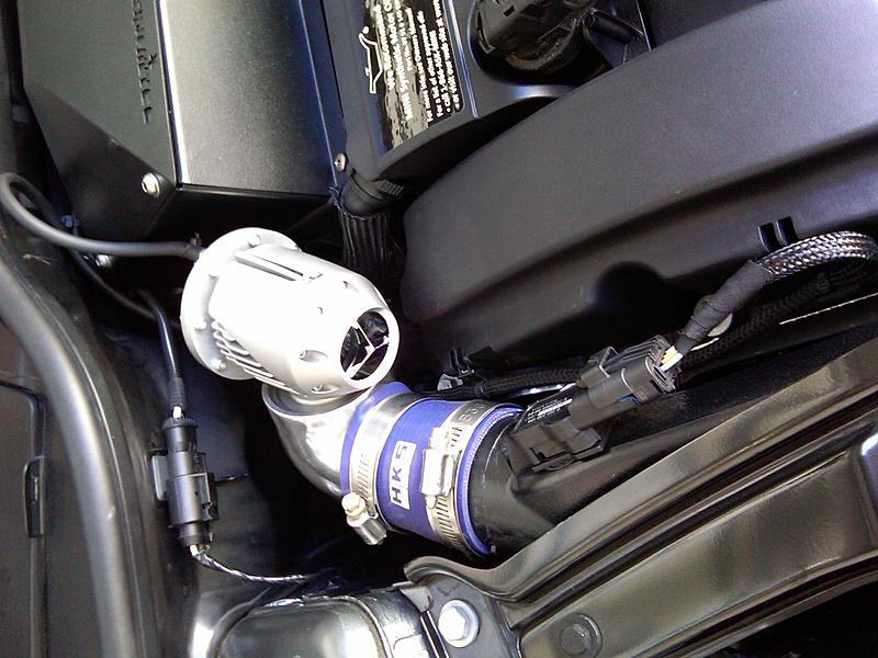

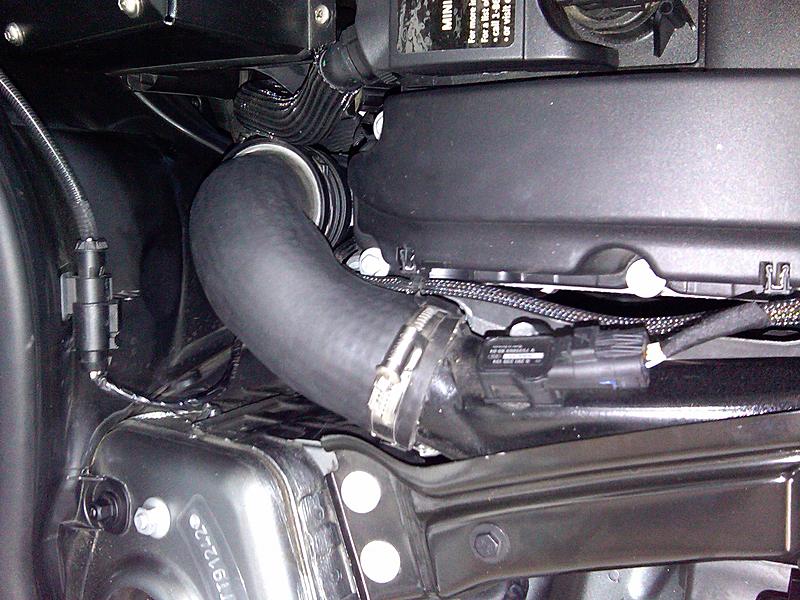

So I broke down and purchased the HKS SSQV BOV kit... very nice. But I'm having a hard time removing the Chamber hose/tube... What's the best way to get it to come off without cutting up my knuckles and/or cutting off the hose? Any suggestions

Here is a picture of the hose that I'm having Problems removing.
what kind of clamp holds the bottom coupler?
ur best bet is to remove the airbox.. upper and lower..
get in from there.. with ur screwdriver.. and rotate the clamp till u get a straight shot at it.. assuming it's ring worm.. like the other side..
Old Jul 4, 2009 | 11:59 AM
sunman's Avatar
sunman
Posts: 264
From: Los Angeles
Thanks for everyone's assistance. I was finally able to pry it off... and the results are great. I'll post a picture later. Have a great 4th everyone! Cheers...

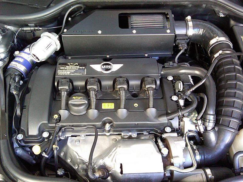

Here are a couple of pix with the HKS BOV.

Looks good man..
hows it sound?

Music to my ears... Seriously, it's really not too loud except when you're at WOT. Overall, it is a nice sound.
