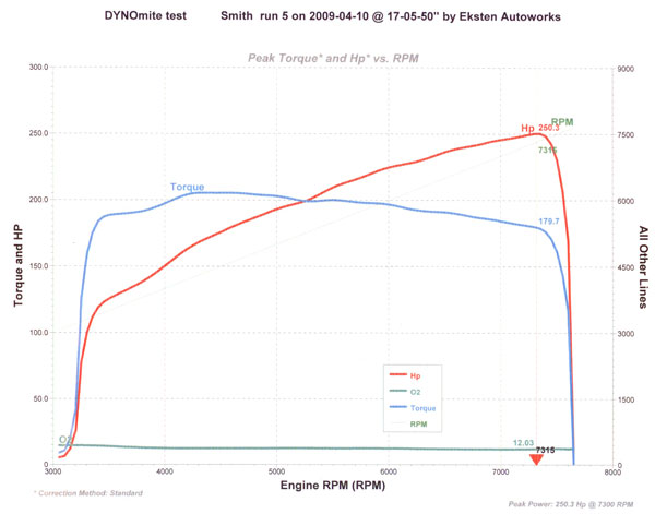

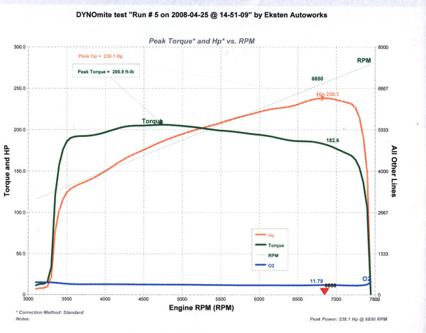

ok, we got the data back faster from the customer... glad he is on the ball
as you can see the car picked up 11whp over the exact same combo
even with temp clipping on the dyno it pulled to a higher rpm than the street cam did under similar circumstances

Hey Paul, sadly though look at the deltas at us "low RPM" automatic guys... there looks to be nary a difference at 6700-6800... the big improvements seem to be up high, where our slushboxes won't let us roam.
Oh well... that is... unless someone figures out a way to get into the ECU/TCU, and besides you and me, I'm not sure there are many other potential customers out there who'd pay for that R&D. hhahaha
Doh. Remote tune needed. I thought you meant this new cam. oooops!!!
