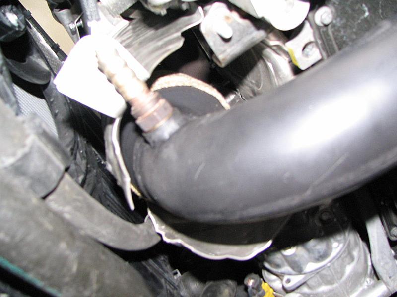

I am now amoung the ranks of having installed and driven with the exhaust depot DP cel-free (only 75 miles so far). Definitly more pull, especially in the higher RPM band. Deeper tone but not much louder. The good news also is I was able to replace the lower heat shield This had me worried not placing it back on so I figured out a way to put it on. I basically cut it right down the middle, top to bottom. I then did some creative bending to get it into place and even more creative work to get the screws back in (including using the old chewed up gum in socket trick to hold a screw). It was a very tight quarters as most of you know! I also had to make a little slit for the lower air sensor. Anyways, I attached some photos for those who have this the DP on and want to try putting on the lower heat shield. I know Hector was impressed

Thanks for the photos. That's my next mod
