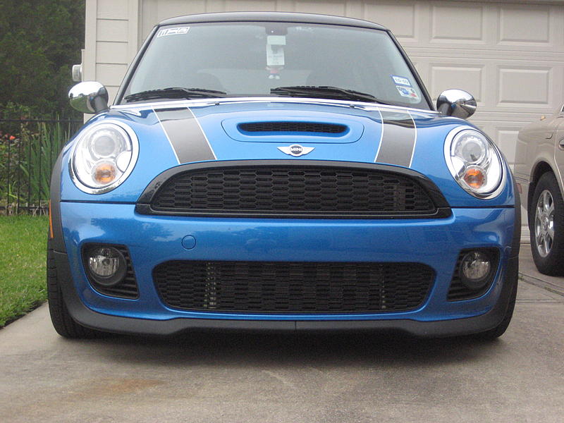

finally got pics
sorry it took so long to get picture but here are a couple
Attached Thumbnails Helix FMIC installed-img_0704.jpg   Helix FMIC installed-img_0705.jpg

how come it seems that the helix FMIC is not centered? it seems to be more to the driver side? is it just me or is it supposed to be like that?
yes the intercooler isnt in the center, i dont know why helix made it like this but personally i dont really mind

The Forge FMIC fits the same way! a little off center, more towards driver side-
