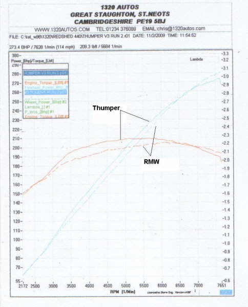

As some of you aware Mike sent us a head to do some testing and see what we can get out of it in the way of performance on the dyno and on the track.
As you can see from the dyno sheet comparing the RMW head and tune on Big Shows car and the Thumper head and Chris tune on 1320’s Mini, it stacks up pretty good.
We still need to do some more testing off combos as and when we can but we have achieved the following so far.

A quick change in the contrast to make the lines a bit more visible. Might just be my screen, but I couldn't see the blue lines at all in the original.

Paul
Can you change the colors on the dyno chart. Very hard to read. My old eyes can't see them that well.

More torque and hp from 2500 to 6500 - the "sweet spot" oooohhhhh yeah! This is the "range" in which most people drive and hence more usable power than a BVH.
I have had a Thumper head for a while and I didn't need no dyno to tell me that they rock!
Mike has been saying this for a while that the smaller valve heads are great for daily driving ...well there is the proof

Nice area under the curve, especially for a street MINI, but what about at higher revs? Would the Race head work better above 7k RPM?

The TPR-2 head hits 7500+ rpm with ease. IF you are making that kind of 8000+ rpm, then you would need to email me the profile on the camshaft.. the power rev range and the cam Lift. Then we can discuss the need that your engine requires and make the TPR-3 to your spec.
My experience has shown that the BIG heads are not the way to go on 90% of us , daily drivers!! If you are looking at 8000+ rpm, the you are in a class of your own!! yes?? The dyno sheet shows the power that can be gained with a smaller valved head. So if you dont go 8000+ then the TPR2 or even the TPR-1 Head would be a better performer for your application. The fun is in the drive!! Yes??

If you're using the dyno to prove a point that it made more power, why wasn't it faster when you had slicks?

Less Top end power on the stocksized head....However, it gained more Low-mid range as what has been advertised
