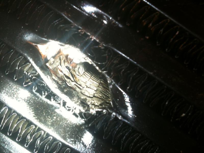

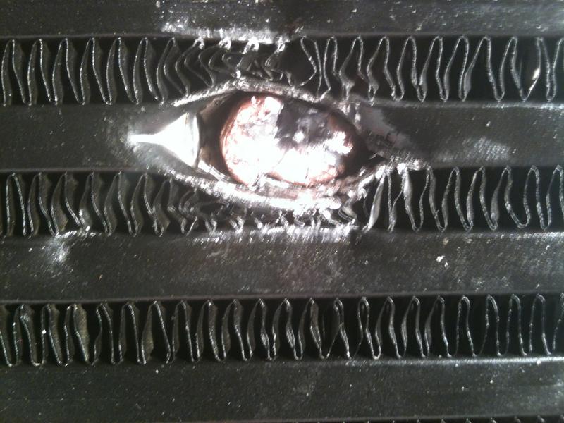

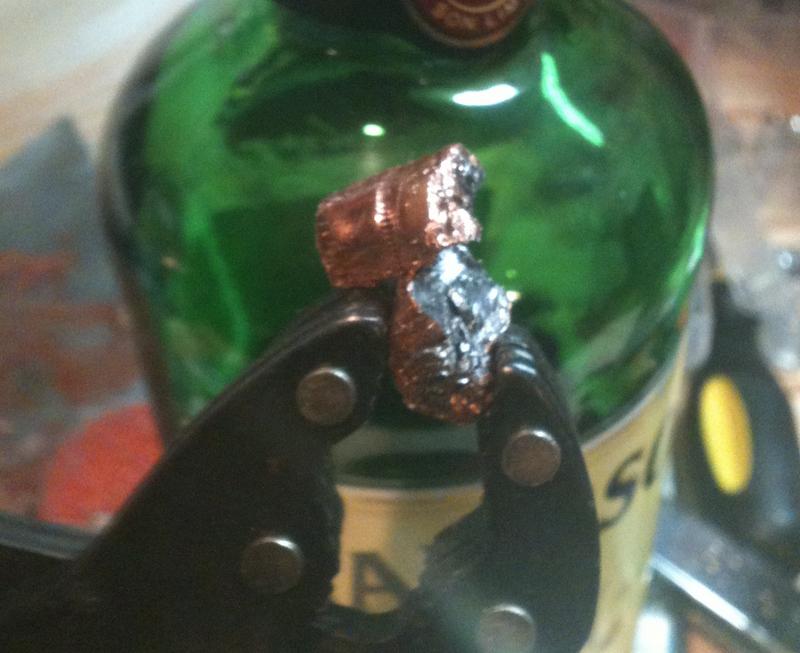

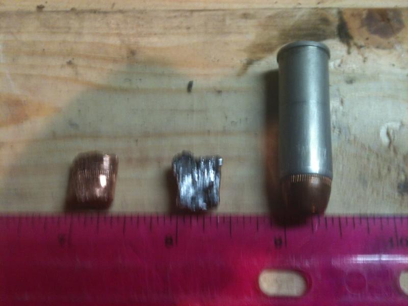

I don't have a clue how it got there, and with no damage to the bonnet, or air diverter, it must have been either a Marine Corps Scout Sniper, or a one in a million exhibition in dumb luck. My diverter, as it is set up is like a scoop beneath the hood scoop, and it was covering up what I needed to see. Once I took it off to begin the tear-down, there was an obvious issue. There was oil everywhere on the I/C and a good size hole. The pictures show what the investigation gave up... If you don't know what you're looking at, it is what appears to be the remnants of a copper-jacket, hollow-point .45 Long Colt round...
I feel compelled to point out that in this case, my head gasket is just about 100% super splendiforous. Thanks for the help though. I was prepared for much worse. The I/C is now as ruined as Lindsay Lohan, but its an hour each way to my parents' house where my extra OEM intercooler is...
Thought of the Day:
2 hours on the road, in low traffic, on a nice day, on I-64 beats the S*** out of replacing a head gasket. Hope you all have a good weekend and thanks again!

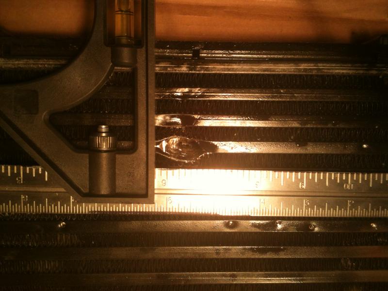

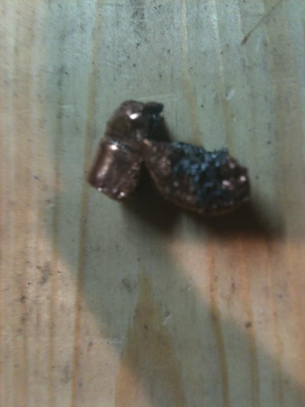

more pics

I am inclined to think that was probably a ricochet since the bullet is so deformed. How have you established it to be a .45 Colt, and not a .45ACP which are so common? In either event, it sounds like the St. Louis gangs are pretty serious if they are using 45's.

So... Sorry to leave the saga open ended for so long. First, I did not determine it to be a .45 Colt. I happen to own one and was looking at my ammo for comparison. As a result, I typed 'Long Colt' accidently after .45. That measurement, however, does seem accurate.
Anyway, the car still isn't running. So I need help. It starts, barely, and runs like a Wankel Rotory Motor with a vaccuum leak. I've so far replaced the intercooler, pcv valve, supercharger intake duct, intercooler couplers, and removed my oil catch can. All of these showed damage not observed prior to my incident. I'm getting P0301, P0222, and P0123 codes. Does ANYBODY have any ideas where I should be looking for a problem? I just moved and no longer have a garage, but i cant ignore it any longer. I dont think its a major issue. Just something stupid im missing. But I gotta get this thing goin now. Any ideas appreciated.
