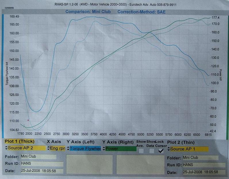

I was the last car to be tuned on Friday. I baselined at 174.2 hp and 167.06 ft-lbs of torque. I finished at 177.4 hp and 169.49 ft-lbs.
I, too, was really lean at low rpm, 15:1! Jan asked whether I was feeling weekness when driving in that range, and I said yes. I had never felt comfortable at blind stops. Well, Jan fixed that! My low end is so much better now. I have gained about 20 ft-lbs at 3000 rpm, and 10-20 ft-lbs from 2250-3600 rpm. In the end, I saw increases throughout the entire power and torque bands. I have 160+ ft-lbs from 3000-5300 rpm!
I have a new car now! I could tell the difference even in reverse!
