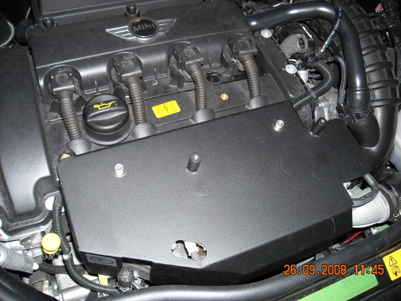

This rooster....
Originally Posted by hdvato
Good to hear - When I received my shield, the aerogel blanket fitment looked like 'socks on a rooster'.
I sent mine back, awaiting the new design.
has some pretty good fitting socks.
Attached Thumbnails m7 heat shield installed-dscn0011.jpg   m7 heat shield installed-dscn0010.jpg

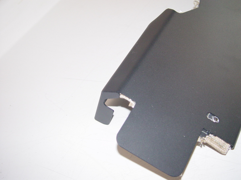

Here's what I'm talk'n about:

I see what you mean. If your replacement is anything like mine it should be a vast improvement.

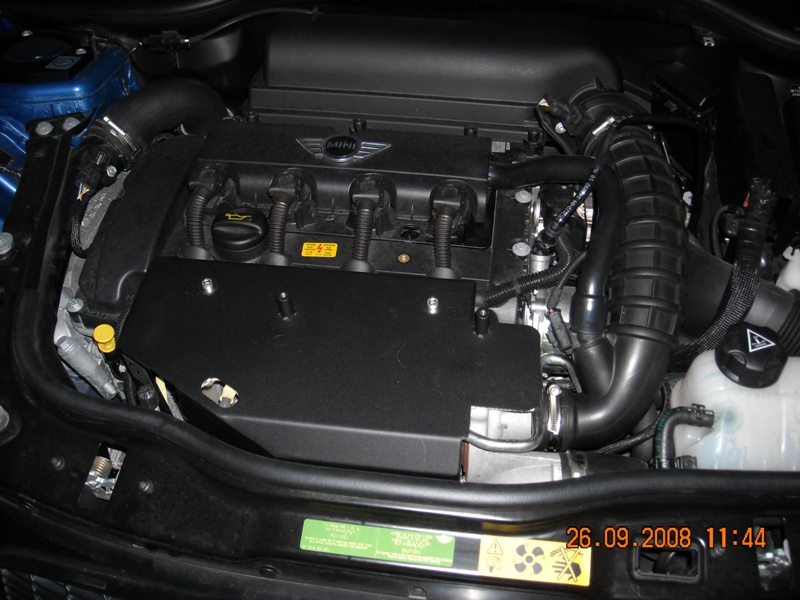

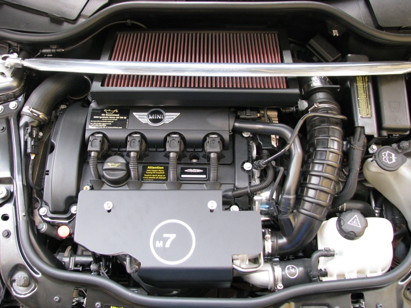

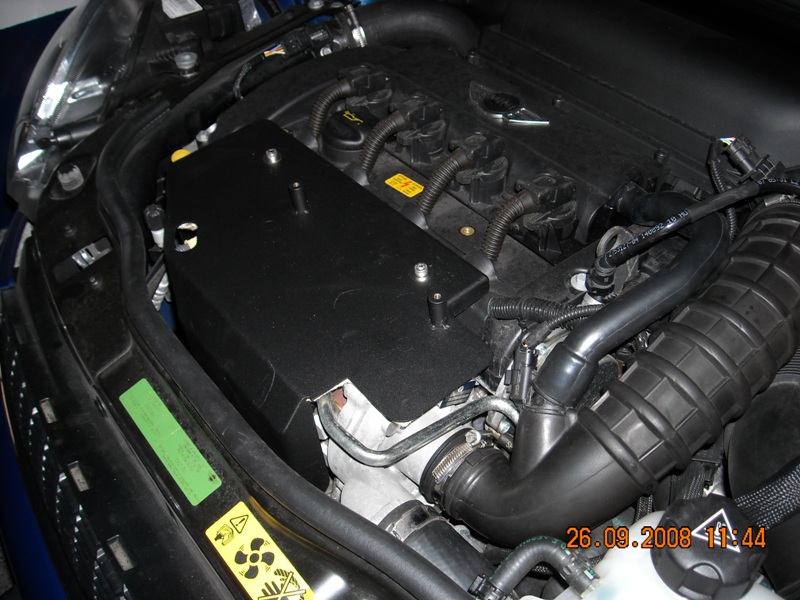

here's what mine looks like installed
Originally Posted by dtsoccer6
jeeze i hope the one they sent to me isnt like that. good to know the replacements are looking great though.
The fit is very nice.

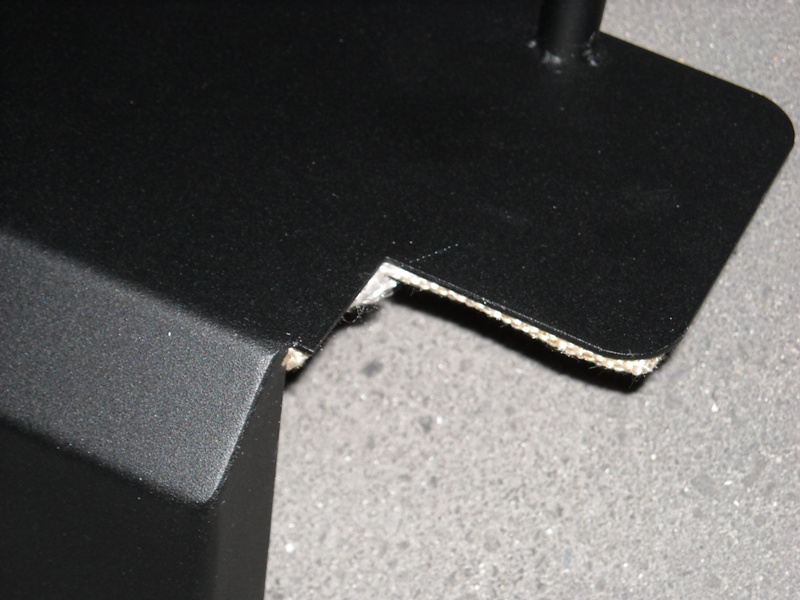

Installed mine. I removed the double stick tape and replaced it with OEM felt strip so it can be removed for service without issues. Added a little detail to mine

Findtape has rolls of various felt tape materials that are the same as the various makers use.
I always have stock on hand of felt materials in various thicknesses and widths to fix the issues. Some of the materials can be used exterior also.
Here is the link to one of the materials on findtape:
http://www.findtape.com/product412/J...tyne+Felt+Tape
So ... I removed the double stick tape since it will make it nearly impossible to get to some parts on the engine with the shield stuck down hard. I got a 2 mil roll of exterior grade felt in black out and put it in place of the tape (cut around the openings) and installed the shield.
This way I can remove the shield to get some of the wiring in the area and the MINI shop can remove it if they have to service the ignition wires without issues.
Hope that helps.
