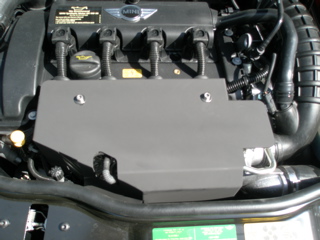

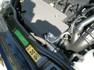

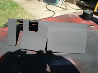

My heat shield was the earlier version and was contacting my hood so I decided to modify it myself. I don't particularly care for the latest design. I made the hole bigger for the O2 sensor made a slit on lower section, rounded the corners and bent it out some where it contacted the down pipe heat shield. I then put a semicircular notch on the right side where the turbo lubrication pipe is and on the same side at the bottom I cut off the corner where it came in contact with a bolt head. I painted it with rust-oleum high heat paint, it's a very flat finish. I may redo the paint with some high temp automotive semi-gloss. These changes allowed me to push the heat shield back 3/8 to 1/2 inch more than before. I did some aggressive starts so the engine would torque over and so far it isn't contacting the hood.

Nice work! You should send these photos to m7 as well! Maybe they can learn something from your handy work!

Nice work 2008lightening. These sound like some of the mods I am going to do to my shield too. I am also thinking about changing where it bolts to the engine by using the two blank bolt holes that are available. I wasn't too thrilled with removing the two bolts which hold the stock heat shield in place. I checked after bolting in the M7 and the stock heat shield was not securely fastened with the two long bolts that hold the M7 in place.

wow, i heard of fitment issues with this stuff, but supposedly its all sorted with the new equipment. Is this true, I ordered Sept. 19. If not, I'm lucky I have friends in the Sheet metal business who could help me out since I dont have the tools...thanks.

Is it just me thinking that for $200 you should get a product that you don't have to cut, file and paint just to make it look like it should from the factory??

thats what I'm hoping with the new updated version! lol It's hard to account for engine movement and torque under the hood while driving. I agree, you shouldn't have too, and 200 seems a bit high anyways, but it does a great help to your engine bay eliminating a good deal of heat soak. However, you can return the shield and m7 will get you a new one, but why do that if simple modding diy style works just as well? It's preference in that method.
Many people mod their mods, I know I do.

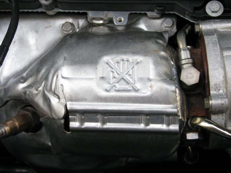

I agree. I am seriously thinking about creating new holes on the shield to mount via the preexisting holes. I am not entirely sure why they did not use them. I will post pictures.

The two holes that you are referring to are the ones on the ali heads. Honestly, I would not use those for the possibly the same reason M7 decided not to, vibration and stress and can crack. The heat shield will vibrate somewhat in the direction that has the weakest points on those holes in the ali. When it does crack (and it will, just a matter of time), then possible warrenty issues can pop up .....
You would be better off replacing the bolts with threaded studs of the equal length, running a stainless washer and nut all the way down to secure the heat shield to the stud/bolt and then placing the shield on and capping it with a stainless acorn nut. Now you have the stock shield secure and the new just as secure without having to drill new holes or worry about other problems.
Hope that helps.
