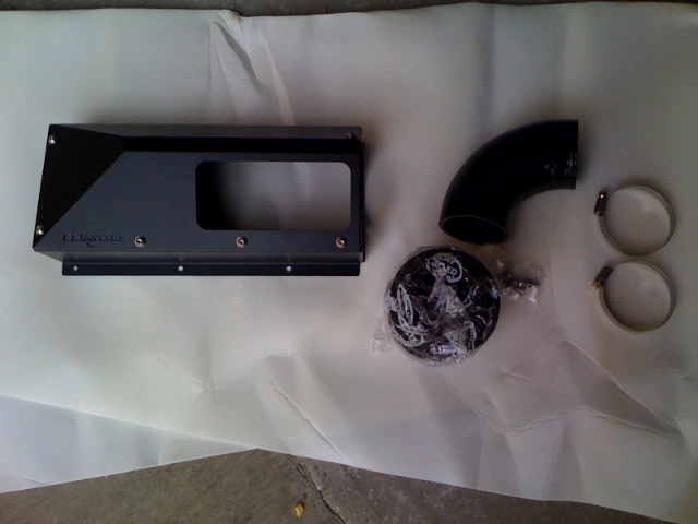

I just received my DDM Race Intake (w/o ram scoop) from Way and will be installing this evening, so I'll let you know how I like it. I ended going with the Race instead of the Street because of the finish (looks OEM vs. aftermarket). It costs a bit more. but it will depend on your pocket book.
cant wait to see the pics!
can you also take some pics of the intake itself BEFORE you install it? i just want to see what is included with the intake kit.
it looks like it is box that bolts on TOP of the lower half of the oem airbox.
Sure, I'll take some pics of what's included in the kit, but it looks exactly like what you have except for the foam piece that surrounds the opening on the top. I believe you get that only if you get the RAM scoop too.

I have attached some before and after photos.
The installation did not take too long, but I did run into a problem with attaching the MAF to the DDM intake. The opening was sized a bit small , so I called Dave at DDM and he told me that it is probably due to the thickness of the powder coating and try and sand and/or file down a bit . In order for me to finally get it to fit, I had to expand the opening by filing approx. 1 mm all the way around (more than just removing the powder coating), and it was still pretty snug to get in - definitely not going anywhere once you get it in the opening. Get one of those files that are rounded on one side and flat on the other if you don't already have one. It makes it a lot easier and cleaner if you have to file. Unfortunately I only had a flat file . Also, the air tube connecting the MAF to the engine shifted over a tad, making things a bit more snug. This includes the line that goes up and over the air hose - hopefully it's not putting too much stress on the connection end.
Anyhow, took it out for a test drive last night and it sounded great when shifting with the turbo engaged psssssttttttt. Seems like there is better throttle response too, or it could be my imagination . I'm very pleased with how it looks.
As far as maintenance of the filter, it probably won't be any more difficult to access than if you had the OEM filter, but if you have the DDM Street Intake it will definitely be easier to access. I'll post some other pictures of the CAI in my gallery.
