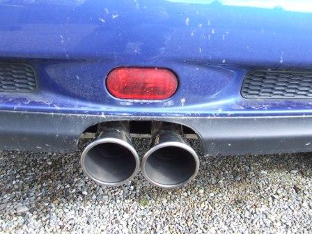

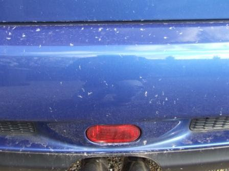

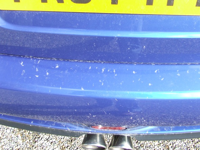

Here is an example of the vault exhaust losing fibre glass packing
Attached Thumbnails Volt MCS Exhaust-dscf0302.jpg   Volt MCS Exhaust-dscf0303.jpg   Volt MCS Exhaust-dscf0305.jpg

i will probably be cutting the volt exhaust open to see what the problem is my fabricator said if he refils tha cans the same thing would probably happen .i think its the sports headers. which cause the exhaust to fail. i am now getting free of charge a volt exhaust from the company that sold me the original one i hope this one does not have the same problem

1 FSTMINI think the problem is that resenator is so small that the force from my manifold and sport cat is blasting the fibreglass through the resenator the header is a 421 header the cat is verry free flowing i have even used the janspeed decat and canot tell any change in power between the sports cat and decat that i used on my old exhaust. as far as i can see most cars on nam with the volt exhaust do not have headers .
