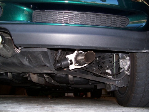

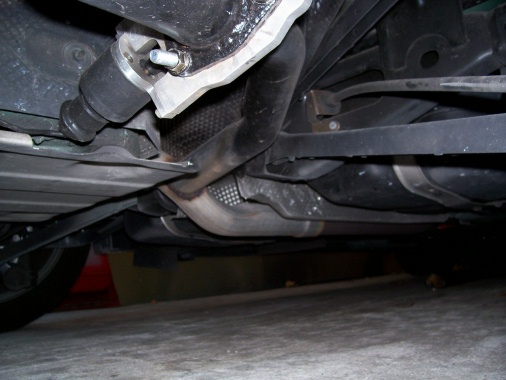

My cut out..
I went and took a few pix of my electric cut out!! The "FUN" of the cut out is that YOU CAN control the noise, whether running under boost and pushing hard, or cruising thru a neighborhood at 1 am in the morning... it is your choice!! Whne the MINI is running and on no load.. yes you will lean the fuel a bit!! Under boost and running hard.. there was NO fuel issue as the ECU is all jacked up.
I Did pull 3 whp over my 1-ball!! Is it worth it?? Ask the ricer that is behind ya...lol
Just me.................................
Thumper
Attached Thumbnails Electric Cutout-cut-out-1.jpg   Electric Cutout-cut-out-2.jpg   Electric Cutout-cut-out-3.jpg

Thumper,
Just curious, but why did you have the cut-out all the way back there? All the setups I've seen put them closer to the header (to give the effect of an open header)...

MCS Mike... YEP!! Remembering the ECU runs lean under cruise.. yes?? and under boost, it goes FAT!! SOOooooo... I did feel and loose some at cruise torque.. not to much, but in these cars it doesnt take much!! Under boost, the power was there all the way thru.. I picked up 3 WHP over the 1 ball!!
Skillet.. my cut out is all the way at the END of the system.. look closely at the above pis... cool?? ANY futher forward would have caused more issues as far as a/f and torque.. yes??

I think where he has it located is ideal since it would preserve some of the scavenging effect but allow the exahust to freely flow before the most restrictive part in the system. This looks like an awsome compromise between just a one-ball upgrade, and paying for a full cat-back. The cut-out switch wuold be perfect for the one remaining empty switch location in my switch panel.

That does make sense. I'm just used to seeing cut-outs (dump-valves) up closer to the header. I bet it still sounds nice though

On a turbo-charged car or an 8cylinder car with long-tube headers closer would be preferred, but on smaller engines the exhaust gasses passing through the exhaust system actually creates a suction effect in the cylinders as the exhaust valves open, this is where the "Free flowing exhaust causes a loss of torque" idea comes in (this is extremely simplified). Dumping the gasses too soon, or using an obnoxiously large exhaust pipe diameter, causes a loss of this suction or scavenging effect as it's known. Having a length of relatively straight exhasut piping prior to the cut-out preserves some of this. So his setup should have excellent top-end power characteristics with a minimal effect to low engine speed scavenging effects.
