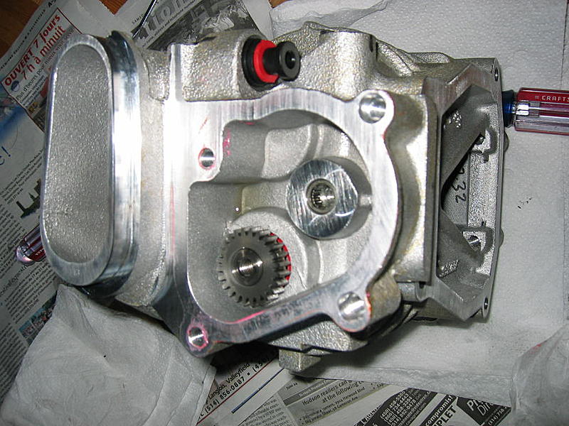

Pics below.
You can use the GM supercharger fluid. Just use an an anaerobic sealant on the case to re-seal it. Just like a tranny.

we found that in one of our cars that over heated, the gears that drive the waterpump on the rear of the supercharger had eaten themselves! THere was no lubricant in the housing either. I saw a similar article by Matt Richter in the latest MC2 magazine.
Here is a pic to show what I'm talking about:

Happened to me ! Water pump gear lube dryed, gear grinding each other, serious noise alarm! replaced before total failure. Looked just like the pic above.
