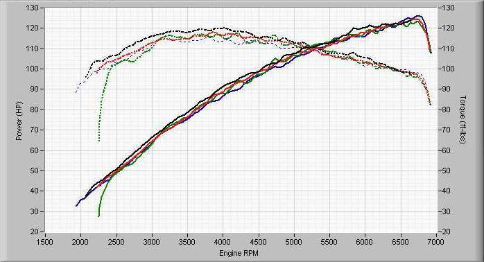

I feel like the G-tech ProRR is pretty consistent, the variations I see are most likely operator & environment induced, here are a few runs overlayed on each other, and a run that is corrected for drivetrain loss, aero drag & rolling resistance to see how it compares to the OEM claim.
