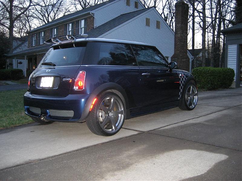

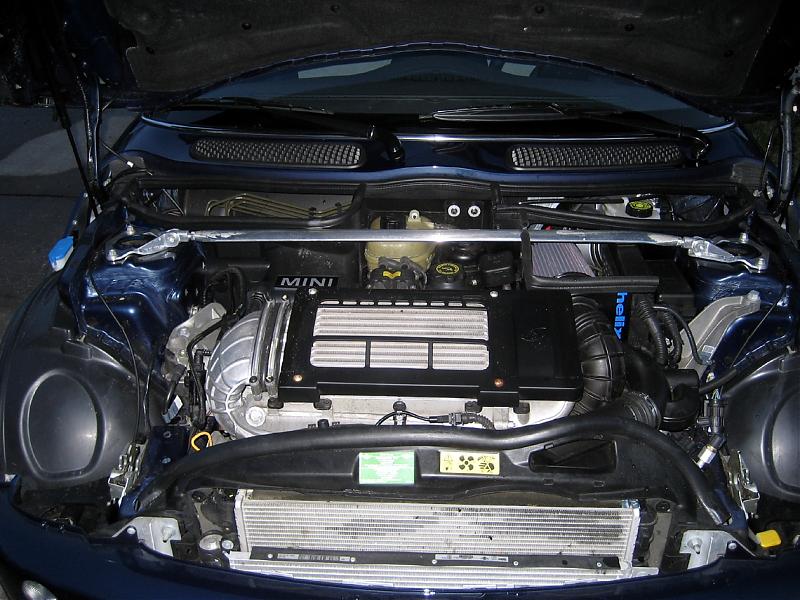

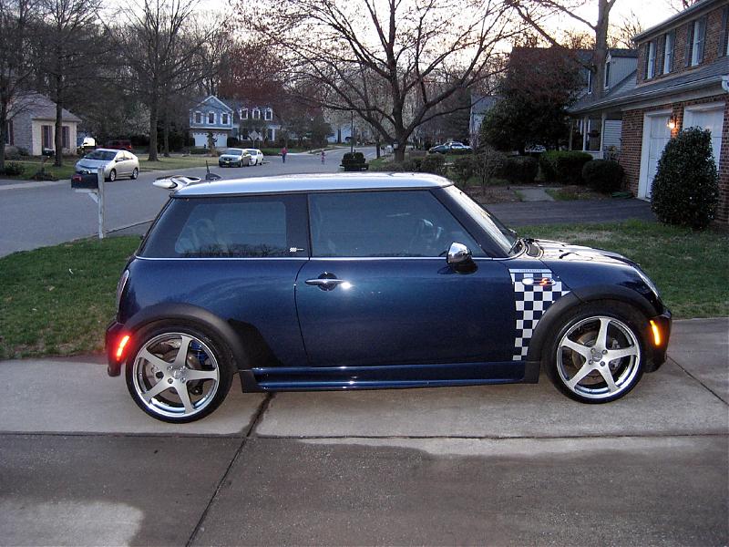

Hello,
First post and a question:
I have an 06' MCS Checkmate, with a few mods that have been done in the last 1000 miles. I have a 15% Helix Pulley, Helix air intake, GIAC software, Borla Cat Back Street Exhaust, as well as Denso Iridium plugs and Nology Hot Wires as engine mods. In addition I've added H Sport Springs, 18" PIAA FR-S Wheels and 215/35 non run flat tires and the car came with a JCW Upper Front Stress Bar and a limited slip diff.
The car runs great, but I'm curious if adding the JCW 380cc injectors will give it any noticeable speed upgrade? I'm sure many of you have done some variation of these mods., any opinions?
I've attached a few pics in case your curious, doesn't everyone like to look at pictures.
Thanks,
John
Attached Thumbnails 380cc injectors with other mods, noticeable perf. upgrade?-mcs-pass-side-view.jpg   380cc injectors with other mods, noticeable perf. upgrade?-mcs-back-side-view.jpg   380cc injectors with other mods, noticeable perf. upgrade?-mcs-engine-bay.jpg
