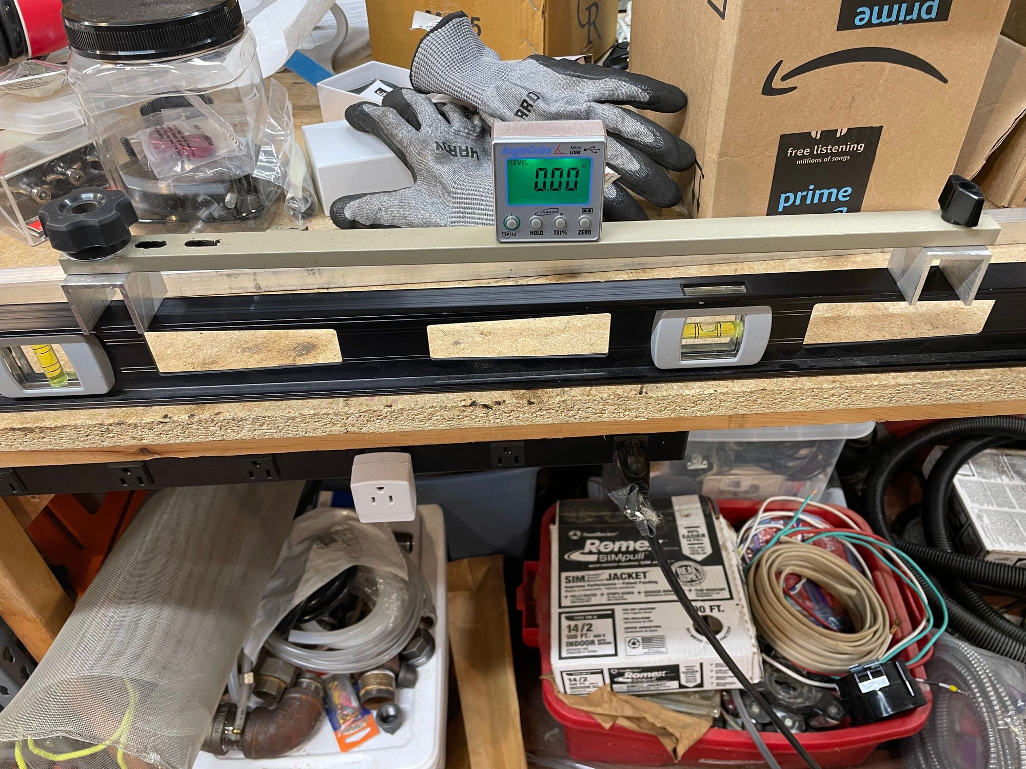

Being a person who is a genius, I thought that I should be able to do my own wheel alignment. At least the camber part. How hard could it be? I recently bought a digital level gage that has built-in magnets. And it was easy whip up a mount that would span across a wheel, to which the magnets of the level gage would attach. Simple. Right?
Well, somehow my IQ dropped when I tried to use it. No, it turns out that I am no genius. Just a person with a thought who turned confused.
I did take pictures, so I shall regale with the story of my fall from geniusness:
Making the mount was pertly simple. A section of very light weight steel rectangular tubing, a couple of pieces of aluminum C channel, a couple of screws and a couple of ***** and, here you have it:
So, here it is being checked against a level.
The contraption checked against a level
The nice thing about the tubing and the aluminum C channel is that they are both made quite accurately. So, as I expected there was no difference in the gage reading when placed on the level versus it being on the camber mount on the level.

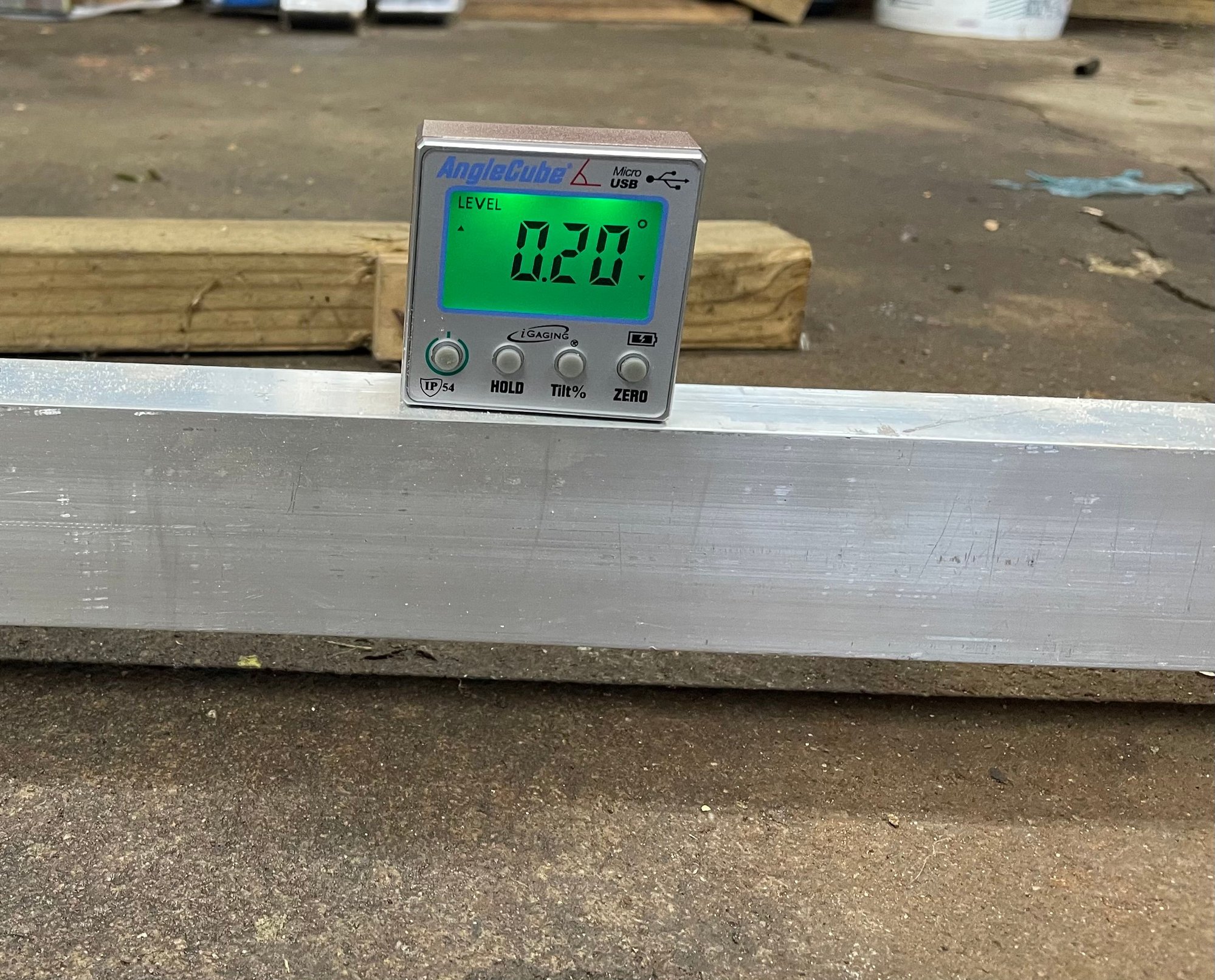

Off to check how level the garage floor is (yes, that is the remnants of an oil spill from a few days ago )
Checking the floor for level
That is a piece of aluminum rectangular tubing. It is setting on a piece of right angle aluminum pieces at each end at about the location the car tires will be at. The right angle pieces keep the tube from hitting any irregularities in the floor between the tires.
Hmmmm???? Not too level?
Off by 0.2. I can compensate for that.

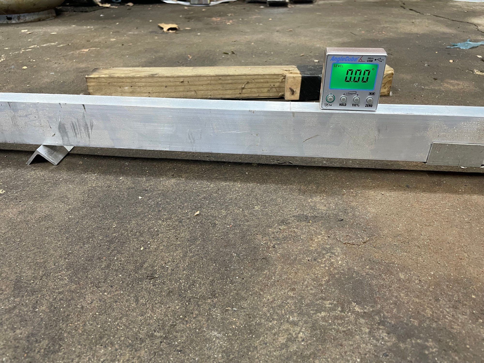

Hmmmm???? The floor fixed itself?
On second check it looks ok. Can that be right?

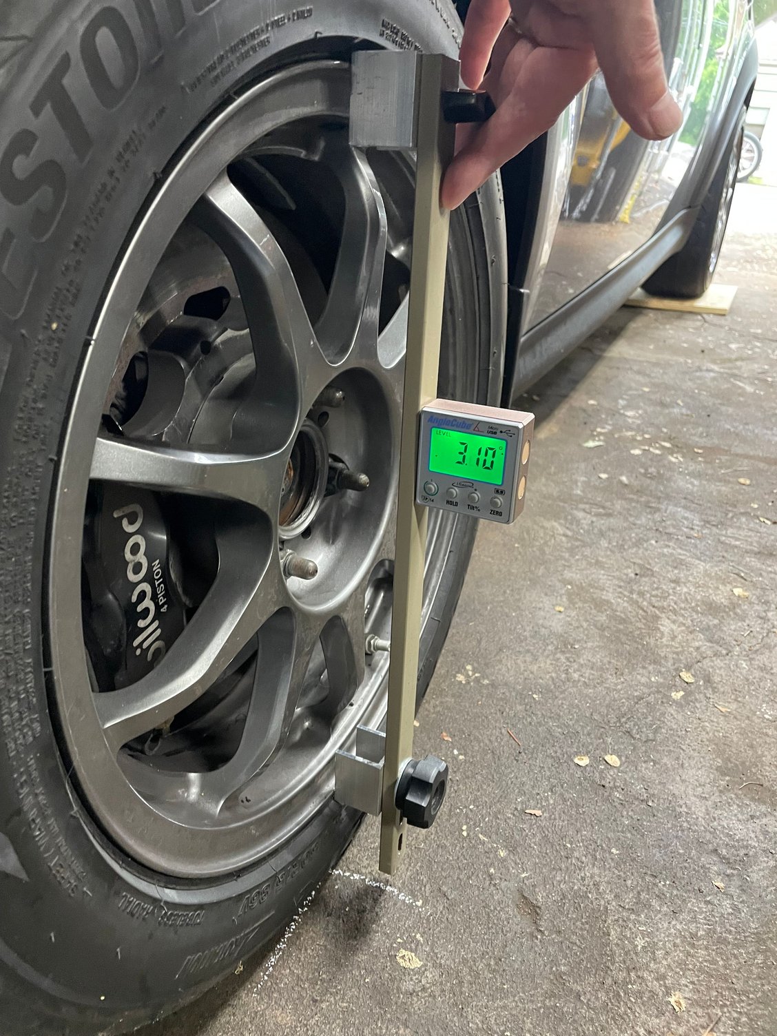

I checked the camber angle and found the left side to be just a tick over 3 deg (3.05)
Tried to measure the wheel camber.
Showing how the wheel camber is measured (an approximate reading because of how I am holding it)
The surprise was that the right side came out about 2.5 deg. Now, I used my eye-crometer to set the front camber, so this difference could be real. I had not touched the rear camber since the dealer did an alignment, so, I decided to check what those wheels were reading… 2.2 and 1.8.
Ugh!
What if the floor is really off by 0.2 deg? If it is, then the rears would both be at 2.0 deg and the fronts would be about 2.9 and 2.7 deg. That would be not too bad.
So, what is it really? I don’t know. I’m just confused.
Time to let someone who knows what they are doing do the alignment.
That might be the genius part of all of this…

Have you tried to level the car? It should also be -0.20 right?
By the way, across the approximately 60" track of the mini, that angle would require a shim of .2 inches to get to level.
I like the jig.

Don't give up on the genius @Eddie07S . It appears that your garage (at least the part visible in the pictures) is almost as disorganized as Albert Einstein's desk was. Otoh, that may be the only thing you have in common with him!😉
I like the jig.
Me
I was able to measure the tilt of the car across the tops of the strut towers. 0.2 deg. Not sure why I am getting the floor at 0 deg. I wonder about the sensitivity of the angle gauge I am using. While the display is to 2 decimal places (hundredths), could the sensitivity be only +/- 0.1 deg? I may be looking for a result that is more sensitive than the instrument I am using, and/or a combination of of other factors. Oh, well.
As it is, the car feels good in both left and right turns. So, I’m not going to muck with success. For that I’ll take it to a professional. However, at my last outing at WGI with the JCW I found that I got better tire wear with lower tire pressures than I had been using. I am going to try lowering tire pressures on my Cooper S now that it has camber.

Outstanding attempt and writeup! My floor is so out of whack that after I open the garage door I often check to see if there's a flat tire.

I hope whoever paid to have my garage floor poured didn’t pay much for it. It is cracked and compressed in a number of spots including where the car tires rest. I did some repairs on it a while back and found that it was only 1 to 2 inches thick, over soft sand. The contractor probably pocketed the cost difference in thickness from what he was supposed to have put in.
If you notice there is a 3/4” thick plywood board under the rear wheel in that one picture. I needed that to cover the cracked depression there and level the rear of the car. So, yeah, not the best place to do a wheel alignment of this type…
