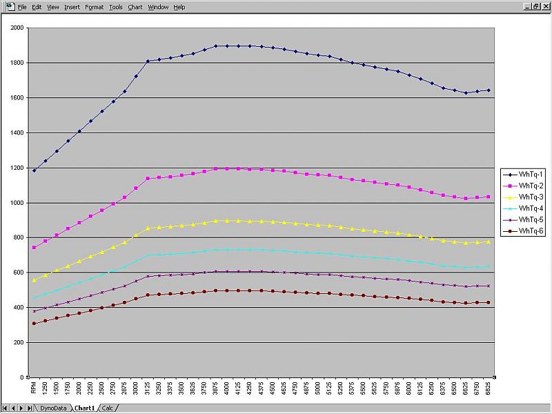

not sure I buy that 6500 shift from 3rd to 4th - have a peek...
I stole your data, precomputed the Wheel Torque values for each gear/rpm combination, and graphed it
visually the question can be stated as follows...
where on any of these lines, starting with the top one (1st gear), can one get a higher Y axis value by dropping down to the next lower line (changing up)

cmt is right - your spreadsheet gives the correct answers, but it's answering the wrong question.
To use the 4 -> 5 upshift as an example, your spreadsheet is correct that shifting at 6500 RPM produces the smallest drop in wheel torque after shifting into fifth, but why settle for *any* drop at all? Continuing to rev past 6500, all the way to redline, will result in more wheel torque for a longer period of time. Shifting at 6500 gives you 582 lbf-ft of torque at the wheel once you're in fifth, but remaining in fourth until 6750 gives you 628 lbf-ft prior to the shift, which is significantly more. So, for the few extra seconds you remain in fourth gear, you'll be putting a lot more torque to the wheels than if you had shifted early into fifth.
Acceleration is directly proportional to wheel torque, and velocity is acceleration multiplied by time. So, the longer you can maximize the torque, the higher your velocity will be after a given period of time.
Cmt's graph is a perfect example of an engine whose torque curve doesn't fall off much past the torque peak. From his lines, you can see that even the *highest* wheel torque available in fifth gear is lower than the *lowest* point on the fourth-gear curve. The same is true of all the other gears as well. So, the correct answer for your particular engine is to delay shifting as long as you're comfortable with.
If you looked at the torque curve for a "peakier" engine, the graph that cmt made would actually show some of the wheel-torque curves for adjacent gears *crossing*. In that case, the correct shift point would be where the lines cross. Depending on the gearing, not all adjacent lines will have a crossing point, and for adjacent gears that *do* have crossing points, they may not occur at the same engine speed. This is why the most sophisticated shift lights can actually be programmed with a different shift point for each gear transition.

Ahhh. Stated that way, now I get it. Hence the original comment that for a car with a relatively flat torque curve, shift at redline....
