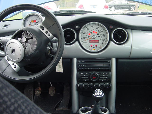

OK....I think we need to clarify what part is peeling and what part is replaceable. My understanding is that the center black piece with emblem is replaceable, but the outer silver is not! I found this photo once that told me that I was out of luck because it is the silver ring that i need to replace on mine....but if it is the black badge then you may be in luck
