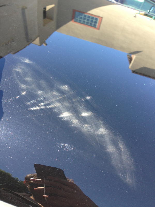

So I'm not super savvy with detailing, and that may become very evident in a second. I may have made a big mistake, but I'm hoping someone has a fix for me.
I was attempting to remove a (what I believe to be) clear coat scratch on my roof. I used Barkeeper's Friend, which I know isn't made for cars, but I've used it on small bumper scuffs and it works miraculously. I usually apply it quickly and then wipe it off immediately with a wet cloth. So...I did that today on my roof for the first time, and now I have big swirl marks that I can't get out. I went to a car wash and they kind of brushed me off like "we gotta keep moving sir, its a scratch."
Any tips for fixing this? Did I permanently screw up my roof? Someone please help!

I believe bar keepers friend is an abrassive may work on glass but not paint. If you are lucky you could have someone who knows how to detail come out and maybe polish it out.

From the looks of that picture, although tough to tell without seeing it in person, you have quite a fees swirls and holograms. The angle and light make it out to look like he barkeeper a friend may have done some decent damage. Before looking to do something yourself, you should go to a reputable detailer (not body shop) and have it looked at and assessed. They can tell you if it can be fixed and jut how good an outcome to expect. The really good ones will even tell you if it is something you can tackle yourself or if you really need the help of a pro.
If you just have a bunch of swirls an no deep scratches (those where your fingernail gets caught in the scratch) an it does not look like the clear coat is damaged, you could try Meguiars ultimate polish to see if it improves. But please be aware that many readily available polishes from the local auto shop will typically have a lot of polishing oils and may just mask the swirls and may not fix it permanently. The meguiars products are usually the better ones that you wi find at your local pep boys, etc.

Thanks a lot! Yeah, I'm gonna try to swing by somewhere in the next day or so. There are no scratches that can be felt, so I think it's all pretty superficial and limited to the top layer of the clear coat (but I honestly don't really know what I'm talking about).

You could try some Scrach X to see if it improves the swirls.
You did damage the clear, but it looks fixable.
A dual action orbital would be helpful but you may be able to correct with Scrach X.
I would not take it to a shop because most use way to much corrective action which will give you problems later. Try the Scrach X and then go from there. It may take a couple of trys and some work but it looks like you can correct by hand.
Barkeeprs friend is not a friend to your paint, ever.

I had a bird with some vicious innards leave its calling card on my roof. I caught it within an hour of it hitting the paint, but left some etching. About four or five rub throughs with Scratch X initially made the etching disappear, but it reappeared about 2 weeks later. I hit it again with the Scratch X and it hasn't shown back up.
The damage I experienced is different than the Barkeeper's Friend, but it may take a couple of attempts with the Scratch X over a period of time as it did with mine.

So I used the Meguiars ScratchX 2.0 and it worked great! Thanks everybody for your help. This stuff is magic!
