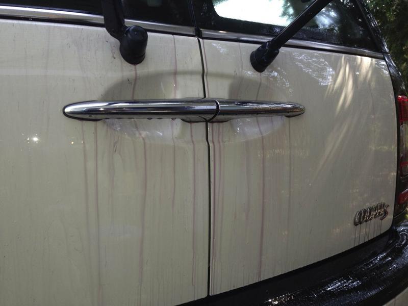

So last autumn I bought a new-to-me '09 Clubman S, pepper white. By this spring it was bugging the hell out of me that there were tiny, tiny orange spots all over the paint on the rear doors and front end. Maybe they had been there before, or maybe all the highway construction followed by a salty New England winter and were newly appeared. Whatever — I was going crazy!
So I did some looking around online. My first guess was that they were rust spots, although how exactly that would happen was beyond me. Lo! and Behold! it turns out this is a known problem with brake dust and (get this) active railroad tracks. The tiny, tiny bits of metal embed themselves into your car's paint, and then they rust. Oh, isn't that cute.
(moral: don't routinely park near railroad tracks! Or live in New England. )
The good news is since this is a known problem, some enterprising chemist has tackled it. There are a couple iron neutralizers, and the one that seemed consistently best reviewed on various auto forums was CarPro Iron X. I ordered a 500ml bottle from AutoGeek.net (after trying the usual NAM sponsors, no joy).
So, the stuff is clear. Spray it on the paint (or wheels), give it a couple minutes, and then (the instructions say) use a sponge to spread it around, then rinse off. As it combines with, neutralizes and removes the rust, it turns a red-purple color.
And hot diggity dog, did my car have crazy purple spots and streaks all over! Check out these pics.
Tiny purple streams kept leaking down from the rear "MINI" badge and from the driver's side mirror for some time; every few minutes I'd rinse it down with a little more water. Eventually it was time to actually dry the car. Orange spots? Gone! Lovely!
The one complaint I have, and it's minor, is that the stuff has a seriously alkaline chemical scent. They say it's "Ph Balanced" and neutral, but my nose says otherwise.
I used way too much — could have used much less — but I was dead set on eradicating the orange spots! But now my driveway smells chemical-y… hmm. Oh well! Some spring rains may help wash it away.
So, if you have these orange spots too, I heartily recommend Iron X. I'm not associated, just a happy customer, yadda yadda. Give it a try.

I still have more to do but the de-iron solution did majority of the work. I smudged it around with my finger a bit to see how much of it took off.
How I got rid of tiny orange spots on my paint-forumrunner_20130902_105531.jpg
It was pretty bad. The rest of the car was 1/4 this.
