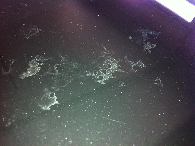

Thanks for the info guys I have one more question though. On my roof there are many small hard to see blemishes or something with the paint it may look like water or soap but its not I bought the car used and since the first time I waxed it I noticed it. There are some here and there and I tried to rub it off but its not coming off. My dad said it was old wax trapped under layers of wax but it also looks like it could be the paint going bad or something what do you think? pic below.
normally it is hard to see so i took pic with flash on.

You could try clay barring to get rid of anything that's left over.

They look like they might be hard water spots, maybe the car was allowed to dry in the sun and that could be the residue left behind.
There are people way better versed in detailing here than I, but I would strip the wax, clean the area with a 50/50 white vinegar and water solution, claybar and polish it. If it is mineral residue, the vinegar solution should remove it without damaging anything else.

First, I agree with several people here who have advised you to check out the Detailing 101 forum. The people there are real knowledgeable. Getting the right products for your car, whether they be Meguiar's, Zaino, or Mothers, will keep your car looking great with less work. But as for your picture, those look like hard water spots to me. In South Florida, washing the car in the sun causes them to appear in record time. To minimize the spotting, I try to keep spraying the car after I have washed sections, and I always wash the roof last since I have a black roof and spots appear the worst on black. After washing and drying with waffle cloths, I always follow up with Zaino's Z-6 Ultra Clean Gloss Enhancer spray because it really does get rid of those pesky spots! And, the spray helps to keep the car super shiny between my Zaino waxings, which I try to do every 3-4 months or so.
http://www.zainostore.com/Merchant2/...CRVM_Offset=20
You probably need to start your cleaning routine with a good clay bar to remove all the residue and prior waxes, then pick the product you want (I use only Zaino or Meguiar's), and stick to those items! Also, Black Wow for black trim around the wheel wells, and 303 Aerospace Protectant for other areas, like tires, inside dash, and outside black trim at bottom of windshield.
Good luck!
