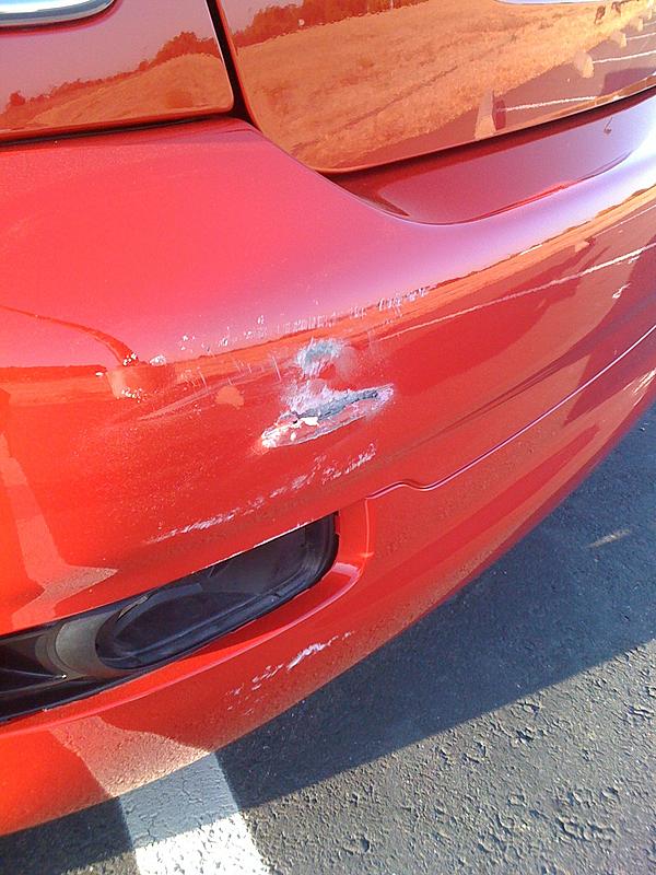

Ok I'm EMC.Guy and i'm a stupid!
I parked my car this morning and apparently the hand brake didn't engage correctly and my car rolled on the parking lot... it stoped when it hit against one of the light poles (Big cement ones so no damage to it) but my rear bumber is broken :( Now i need to have it fixed.
My question here is, I'm located in Sacramento area (Roseville) my dealer is Nello MINI. Does any one have a recommendation fot a good shop that can take of the fix?
Thank you....
yes.. i had to take pictures :(

dont know the locations near you but that bumper needs to be replaced... you're probably looking at $850-1000.

I disagree - it could be repaired, but you'd need to be really sure of the bodyshop's capabilities before you commit to paying for it.

if that was my car, the bumper will be replaced and repainted.

Niello MINI body Shop estimate 1076.00 3 days work, replace rear bumper.
Deductible 500 dollars plus I lose my Distinguished driver discount (100 per year) and get it again in 5 years, so basically i pay for it right now or half now and half over the next 5 years....

Bumper cover swap is pretty straightforward... Personally, I'd order a primed bumper from the source with the best price, have it painted by the same body shop that the dealer uses (for best paint match) and install myself. And save a ton of $$$.

Yeah I agree - you can get a replacement primed bumper for much less than what that repair will cost and find a body shop to paint match.

We're a pretty high end shop, but we tend to price realistically whereas the dealer has to make their cut as well from the body shop they refer you to. I would guess that it'd cost $500 to fix that here in SoCal, and that would involve sanding the paint down, filling the damage, primering, spraying, wetsanding, compounding, and polishing. It could also be done off the car although having it on can help with paint matching.

mini's are very easy to color match. there are usually no alternates. ive done the orange, black, silver, and blues and have never had a problem from my supplier. so that shouldnt be an issue. if the bumper is only chipped which is what appears to be the case by the photo then the bumper can be sanded, primed, painted off the car with no effects of color match and should be no more then 500.
if the bumper is cracked there are very good products out there to repair it, but since it is a flexible part I personally would rather buy a nice used one from a wrecking yard. this lets you use the factory paint as the base for the new paint.

Actually I forgot his was Chili Red when I made the post. That's true color matching isn't really an issue. But I have seen issues on metallics where although the colors matched, in sunlight, they reflected light differently enough to look darker than the OEM paint..something a good painter may have seen while it was being painted within its context. But Chili Red doesn't apply.
