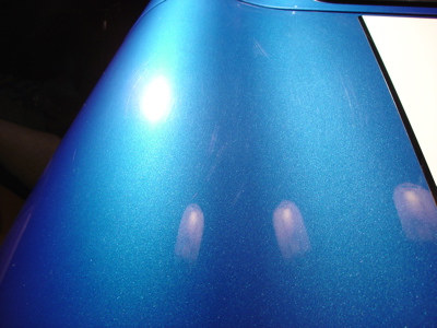

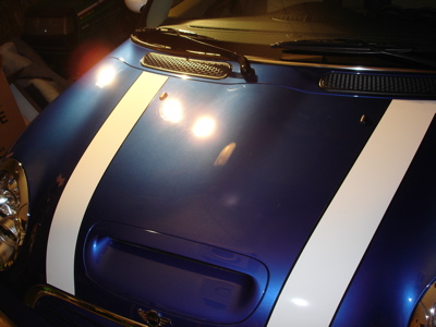

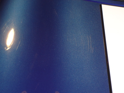

It's difficult to take a decent photo of scratches. But with an extra light I think I managed. Have a look...
Attached Thumbnails Botched!-hoodscuff.jpg   Botched!-hoodscuff2.jpg   Botched!-clayscuff.jpg

Yowtch! I'm no expert, but those look way to severe for clay hazing... But they look too deep for microfiber scratching either. Your sure the clay bar was new, not dropped, even for a moment?

I opened the brand new claybar (fresh from the sealed wrapper in the box). I'm not an idiot, I swear, and I didn't drop it on the floor. Nor did I clay the back end. I worked on the hood, in a slow back and forth motion. This is how I know the scratches came from the clay bar. They were not there before. My Mini used to be scratch free. I should have used more lubricant though, and it was hard for me to type that - believe me

I'm no expert, but it looks like the scratches might've been caused by the washing process. It might've been during the wash after you clayed and that's why you think the clay did it???

Hmm I'm not seeing anything extraordinary here. I just see lots of swirls, typical of most MINIs that aren't polished. I was expecting to see long scratches in long lines to and fro, or maybe a long scratch with a hook or something. For example, this picture is just showing lots of swirls. Are you thinking your clay process did this because I can assure you these existed before you clayed your paint.
^^ +1
i too question if it was from claying... the clay stroke is not consistent
with the swirl lines. those swirls look like just toweling/mitt swirls and improper
wash methods. they may have popped out cause the watever
wax that was on there was removed during the clensing process.
My car was about that or worse when i got it from the dealer as it was
a floor model. tons of deep swirls.
+2 - Those aren't straight scratches - those are cobwebs. You got them from washing/drying, or they might have been "dealer installed" when they washed the car using God-only-knows what kind of process. It's possible that you're only noting them now because you're looking close, or because you cleaned the car well enough for them to really pop out - the same thing actually happened to me the first time I clayed my car (it was 2 weeks old and only had like 400 miles on it at the time). I think that simply removing all the surface contaminents that had built up in shipping made me more aware of them or something. They all polished out to a mirror shine after a single session with a Porter Cable polisher - yay!
Seeing as how you said that you used a back-and-forth motion when you clayed, I'm not thinking that the clay was the culprit here.
