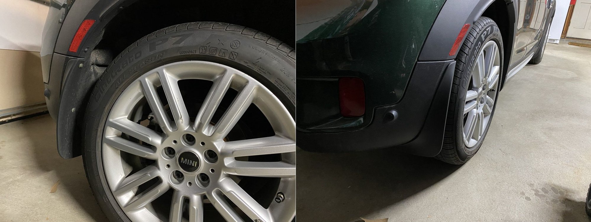

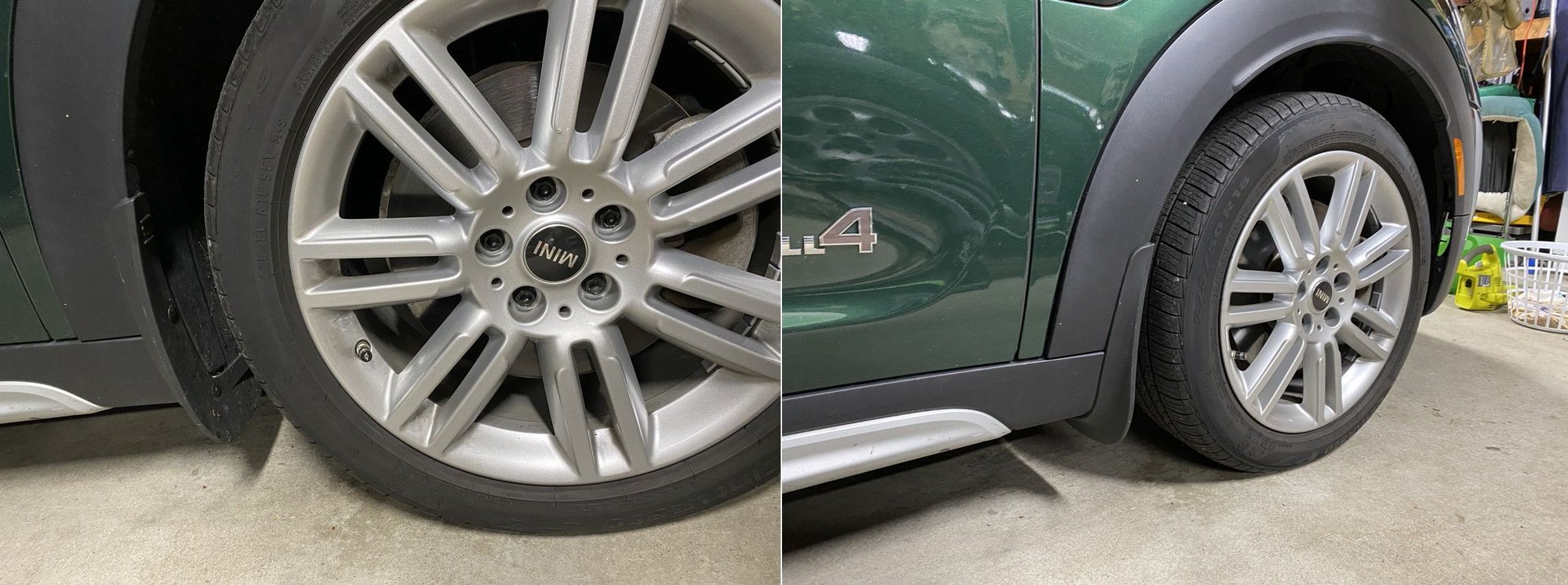

Now to see if it’s worth getting mud flaps so I’m TUV compliant…not sure it’s the look I’m going for
Congratulations on getting the wheels. As for the mud flaps, I personally like the look - subtle, not ostentatious. And after several days of trekking over many unpaved roads around the White Mountains in NH, they do serve a purpose:
Front mud flaps
Rear mud flaps
If you do the install yourself, I'd highly recommend doing this with the wheels off. Installation is a bit fussy, and it's so much easier that way.

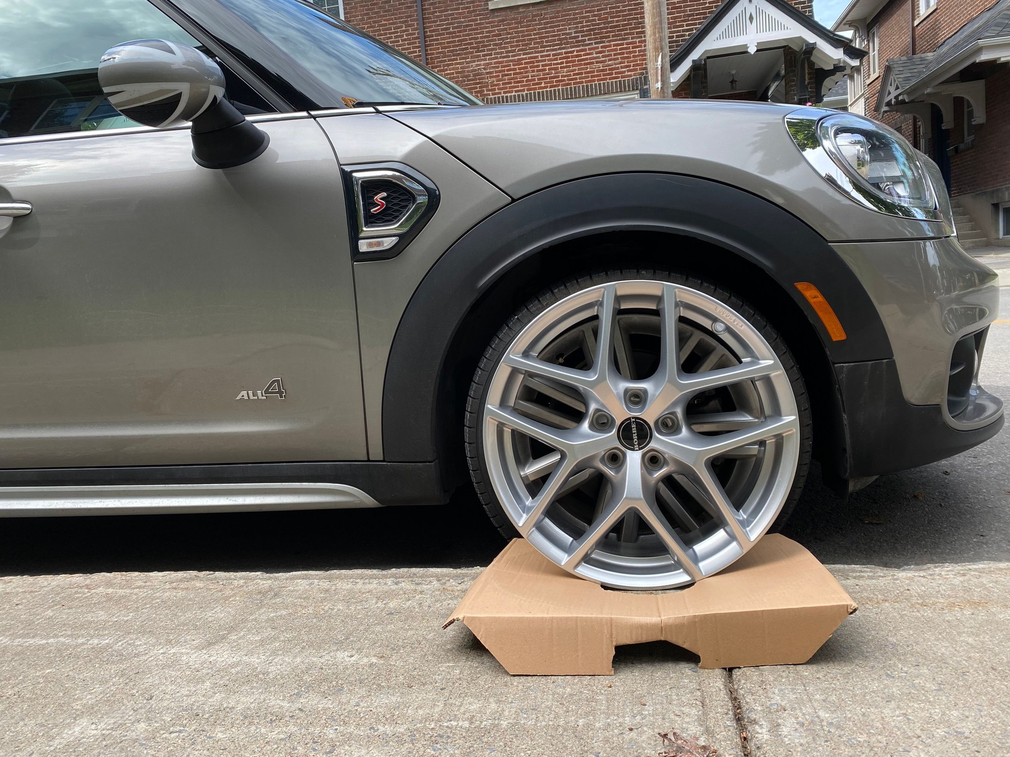

These arrived today. The box of bolts opened in one so there were a couple of pretty insignificant marks that resulted in 75% off for that wheel. Total landed, duty paid was under $800 us. Not sure I can complain, they are much nicer than I expected. Oem center caps fit, which I’ll change. It weights 23.3 lbs. My oem pair spokes (type 532) are 25.3 lbs each.
Now, do I keep these for summer and use the OEM for winter? Decisions decisions.

The question is which wheel will be easier to keep clean and also not get packed with snow and ice and cause an unacceptable vibration. I think the Borbets would be better for winter wheels given those criteria. Also, it will save you the expense of changing your summer tires over to these. They are painted (like the OE ones) so no worries about corrosion.

Great consideration with the snow and ice. Interestingly, I had some 5 spoke open wheel design on an old Infiniti that had terrible wheel vibration but the closed spokes of my masterpiece never seem to hold the snow. I would have figured open wheels shed snow better.
For sure saves a little to put the winter rubber straight on these.

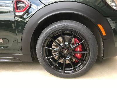

Neuspeed (NM Engineering) from ECS Tuning was my final choice. 18 x 8 inch with 45 offset in gloss black. RSe11R. 225/50/18 Goodyear Exhilarates. Look good, stick out just a tad more than OEM. PLENTY of room. Probably could have gone 235/45's with no problem. Maybe next time! Oh, one of my OEM wheels, cleaned up well, fits in the rear with no problem. Have it strapped down well face-down, and use the wheel as a holder for my bike gear/shoes/etc. Now have a scissor-jack with the top that fits the cupped jack-points under the car, narrow plastic-covered 17 mm socket and ratchet...really glad how it all turned out. Oh, 175.00 rebate on the tires. Oh, one last thing, the Continental TPMS sensors I bought from ECS tuning worked just fine...no coding or other tricks required. Simply put the OEM wheels away, instructed the Tire Pressure system to recalibrate the pressures just like you do anytime you put air in the tires, and it's all working fine!
Here's something that might be interesting. This particular tire has a lot of weights on it (look at about 7 to 8 o'clock). It still had a bit of a vibration. So, I took it off and asked them to rebalance. After a few tries, they decided to simply replace the tire. Unfortunately, the new one won't be in until Monday. Good thing I still have the JCW OEM wheels with tires the same size...that was one of the reasons I didn't go to 235/45's. I wanted to have a spare that wouldn't be odd circumference for the All4 system. I put an OEM on the rear and the new rear up front where this one was. Now that I have different rear wheels on the car, it's easy to see the difference in "poke". Really happy with the new look. Can hardly wait until the new tire gets on and scrubbed in a bit, to see if there is any difference in grip in corners. The geometry, softer treadwear rating, and design suggest it will be improved. As long as they lose grip progressively, and don't suddenly "give up", it will be fine with me.
