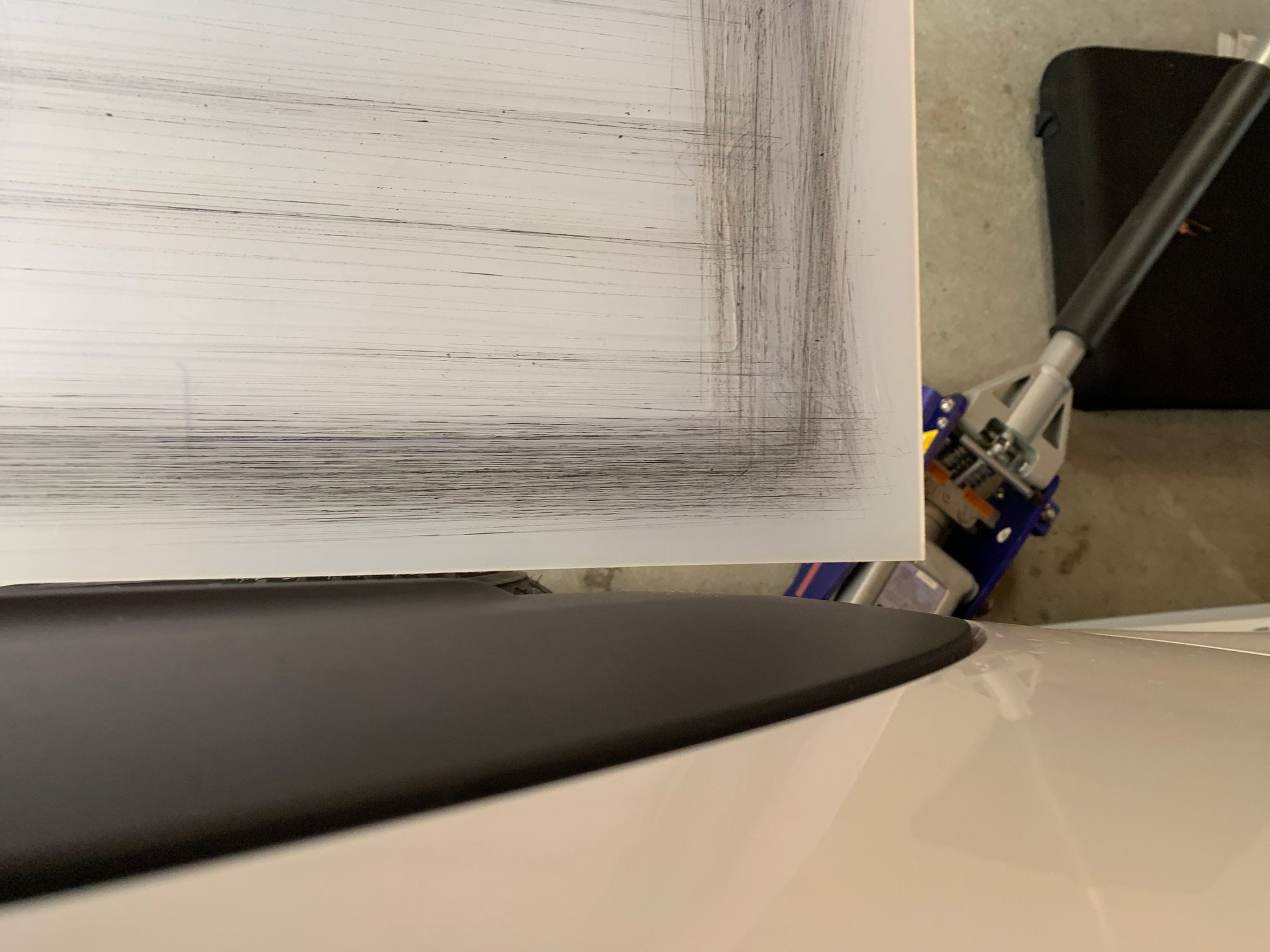

So tried out my new 18x8 rim, et40, with a 235/50/18 tire. Looks way better but still a MONSTEROUS gap from top of tire to well. I still have a bit of room but not much for taller tires but I think any taller/wider tire will hit but even going to a 245/50/18 is negligible and will be real close inside. I have seen other threads here of guys running AT tires at 28 Inches but I can't understand how they do it without any inside fender mods as they say they have not done. I just sent back my H&R lowering springs because a couple of friends told me it will kill the ride of the CMS. I think the look I'm going for is this 235 with the mild lower of the H&R but again don't want to kill the ride. So I guess I'm going to have to just get the 235's and live with it. Hope this answers some questions on size fitment as I know there have been many.
Et40 front
Et40 front
Et40 front
Et40 front
Stock tire and rim
Stock tire and rim
Front
Rear
Rear

I think it looks good. 235 is probably the biggest I'd go on an 8" wide wheel. Gives it a nice aggressive street/multi purpose look.
