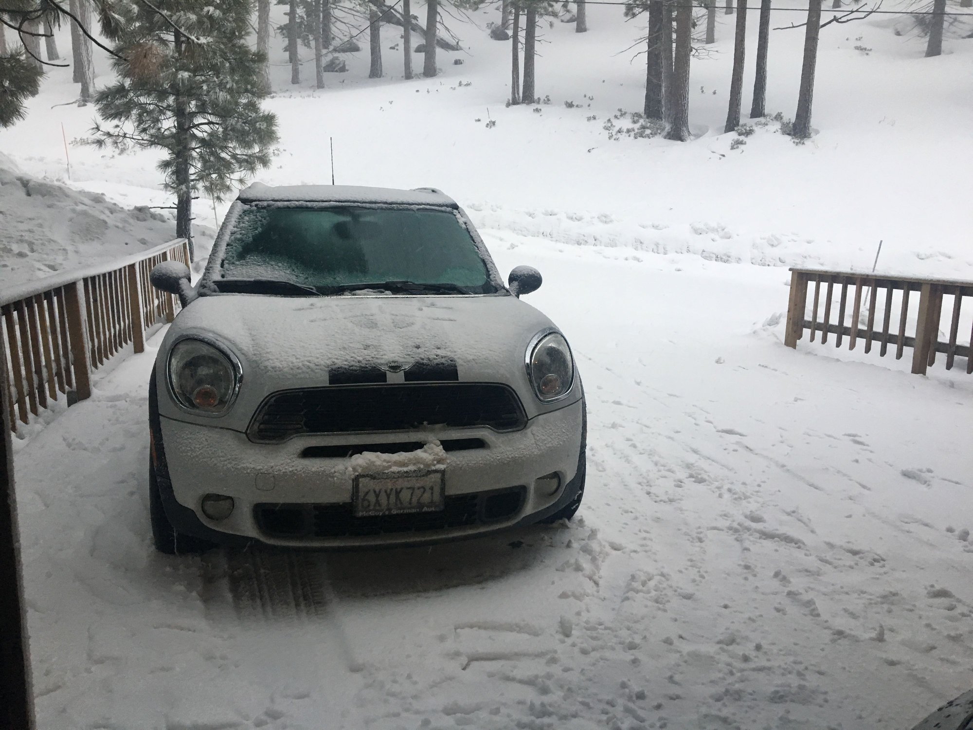

I bought snow tires already on rims from a guy off craigslist who owned a 2015 Countryman S All 4. i figured a few hundred was worth it taking it to Lake Tahoe during a storming weekend instead of dealing with chains etc. Everything was perfect except i couldnt get the TPMS to register. Previous owner said they worked fine when he took them off his car a few months back. Is there a TPMS compatibility issue with a 2012 Countryman S All 4 (mine) and his 2015 Countryman S All 4 (his)?
