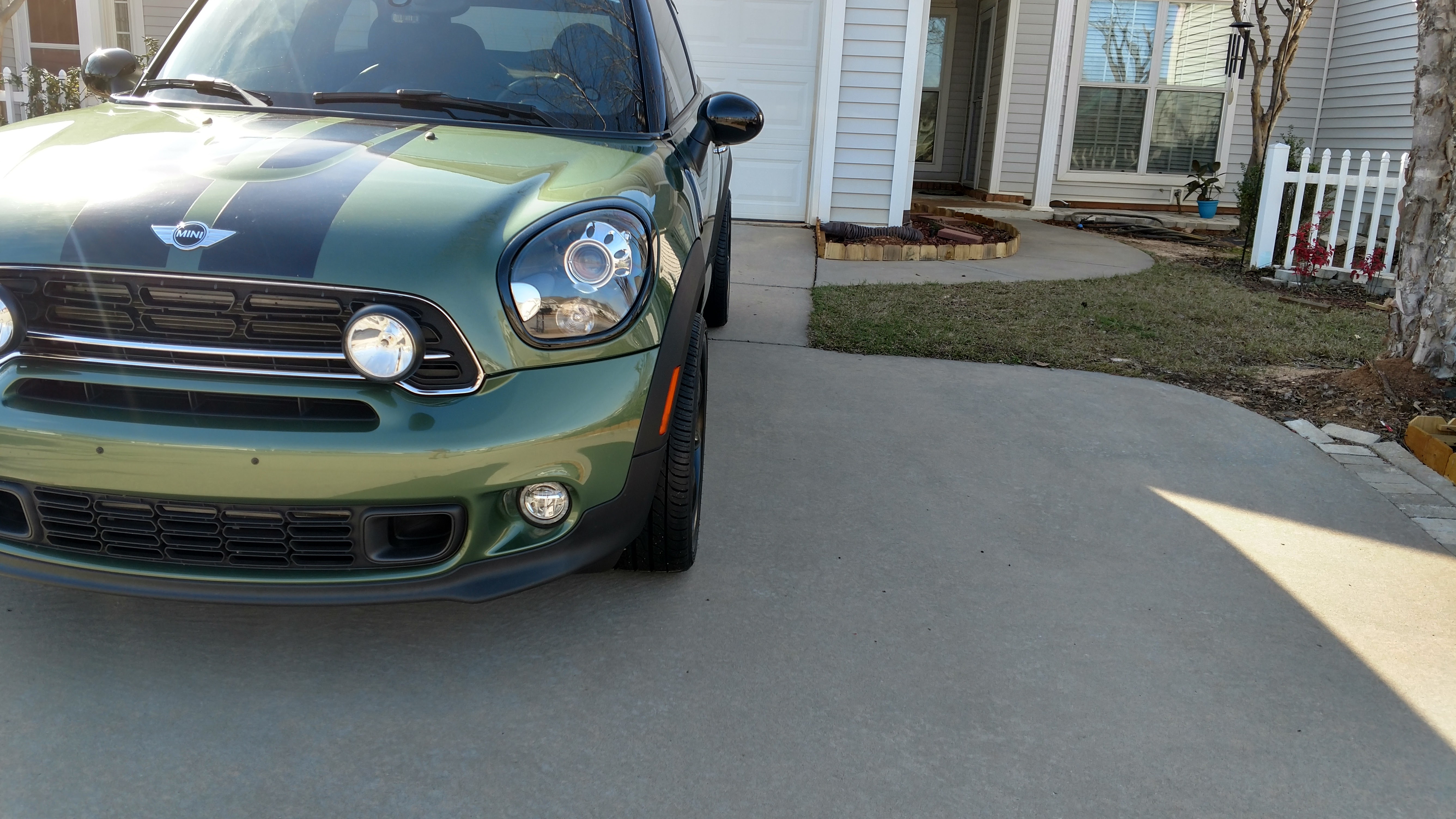

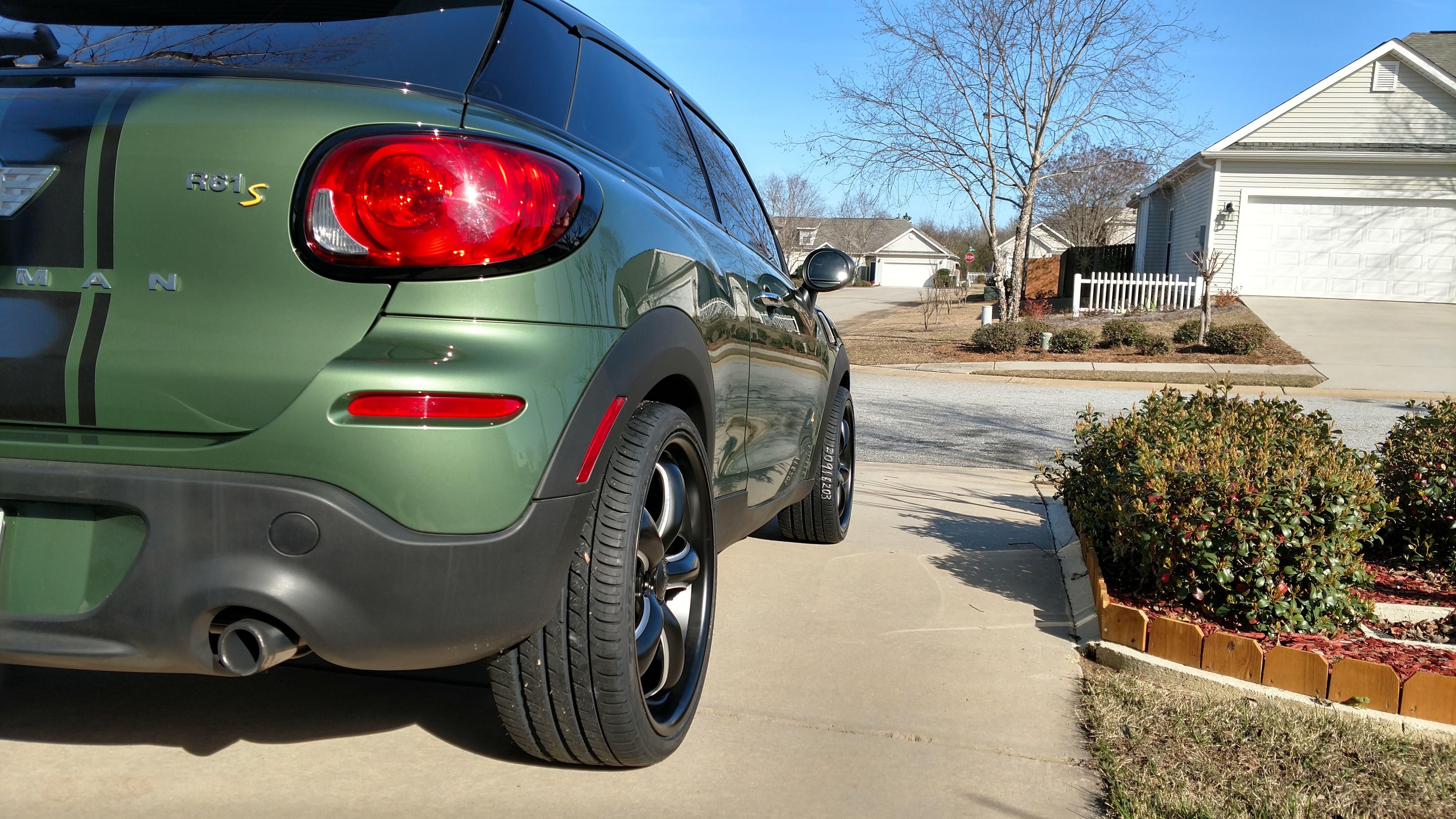

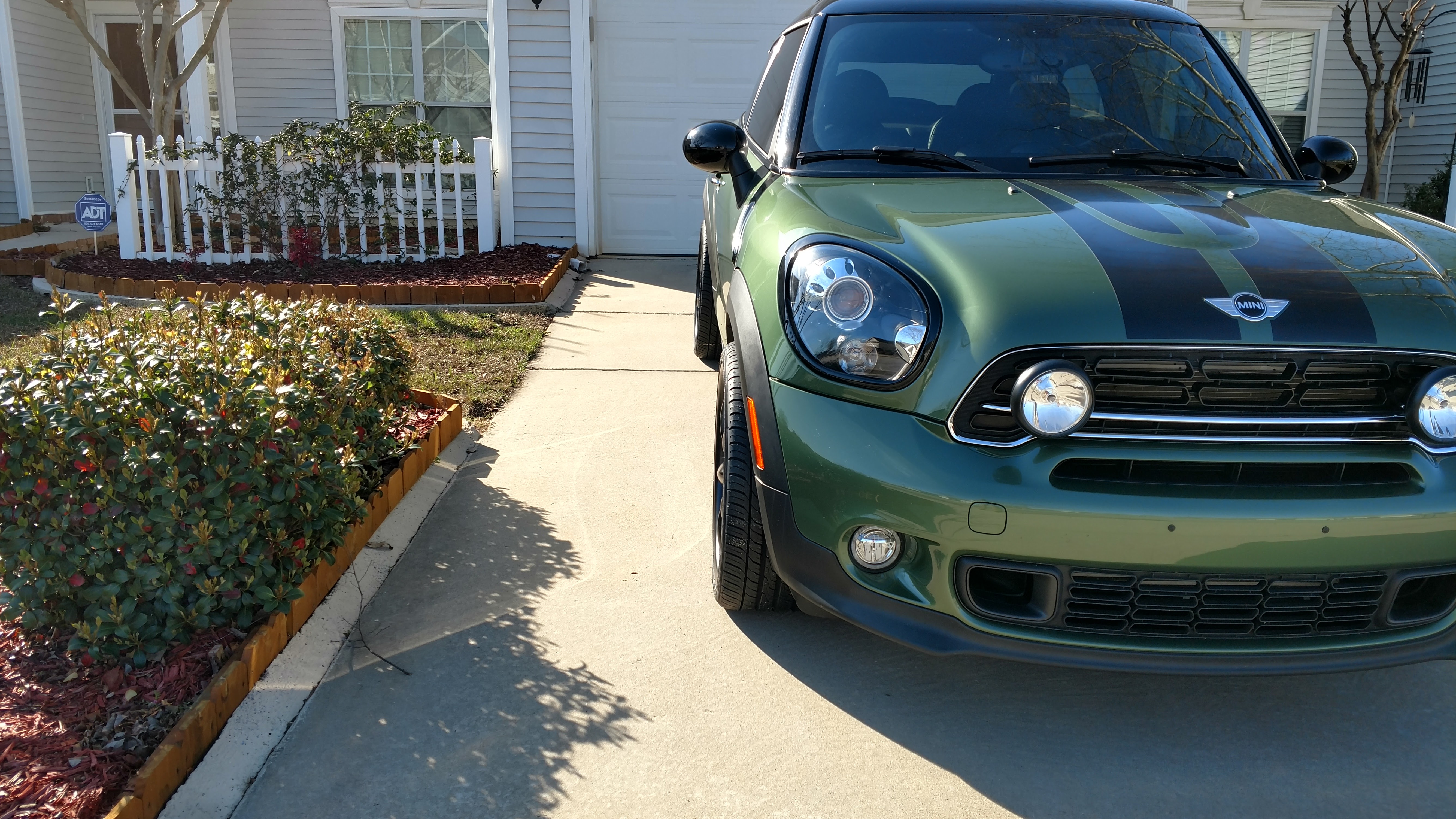

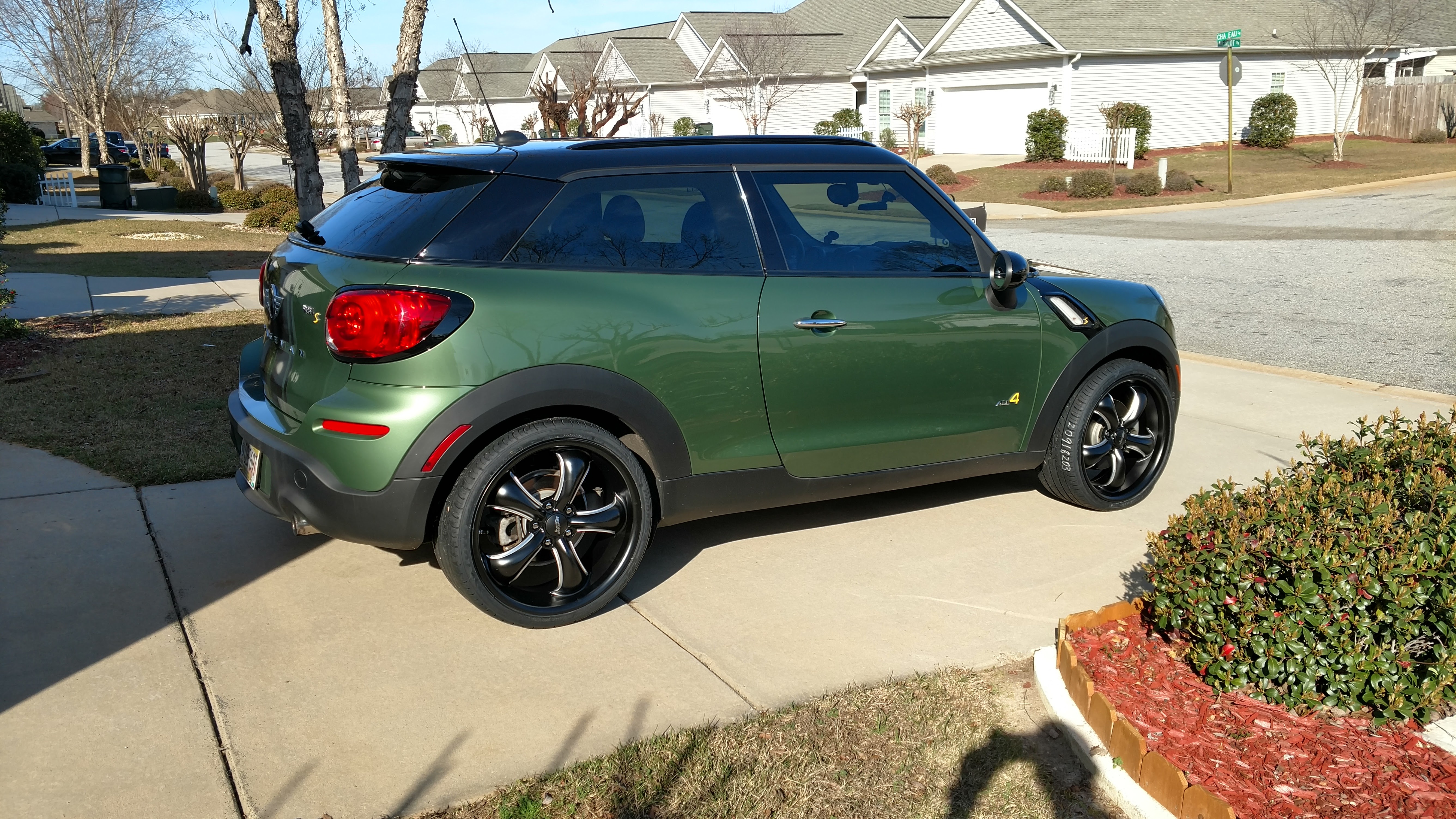

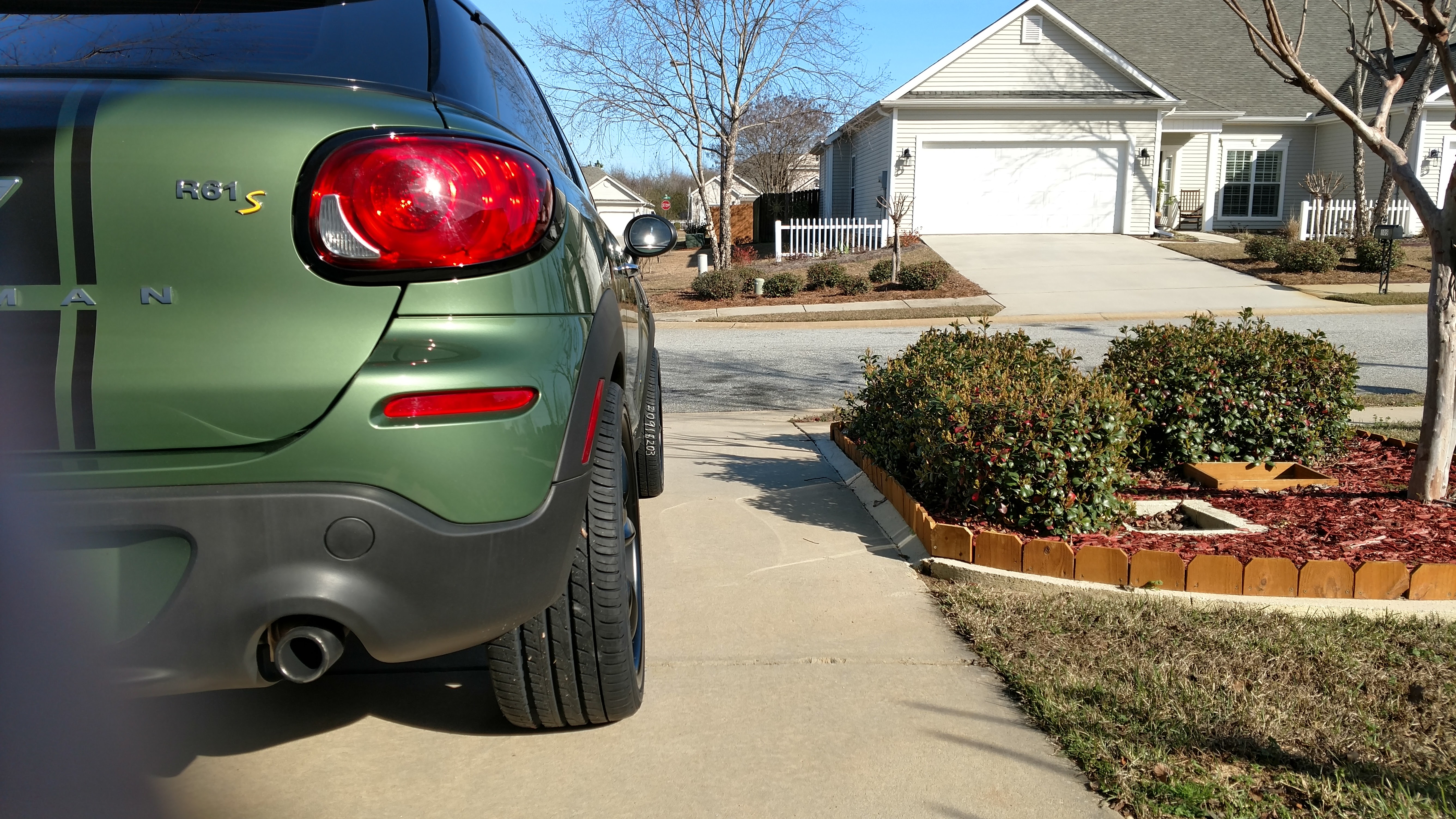

255/30/20 +35 offset on 2015 R61 S All4
Originally Posted by HasAnMTBProblem
"without question" meaning without risking buying something that didn't work and then have to re-buy things.
Here is the answer we all been awaiting. installed these today on stock suspension. clearance check to inner side wall and suspension works just as the references I used above and I just drove 4.1 Miles Not a rub or squeal. these Toyo Proxes 4 Plus tires are actually smoother and quieter than the stock P7 Cinturato All seasons.

Old Feb 13, 2017 | 04:34 PM
YVR_CMALL4_GRL's Avatar
YVR_CMALL4_GRL
Joined: Feb 2017
Posts: 22
From: Vancouver BC
Nice!
Your car looks great! I love the color and the rally lights. Surprisingly the rim size doesn't look awkward or too big. Congrats. You happy?
