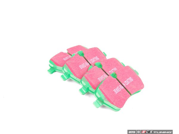

Reds if you are going to track and some DD, greens for the DD. Yellows might be to aggressive unless its a track car.
Countryman All4
http://www.ecstuning.com/Mini-2011-Cooper_Countryman-R60-S_ALL4-Hatchback-L4_1.6L_N18B16A/Braking/Pads/
