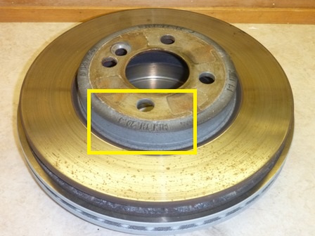

Minimum thickness is cast on the edge of the disc 'bell' on all R56 discs so I bet the R60 are the same if you take a wheel off. Of course, it's measured in them milly meters....
