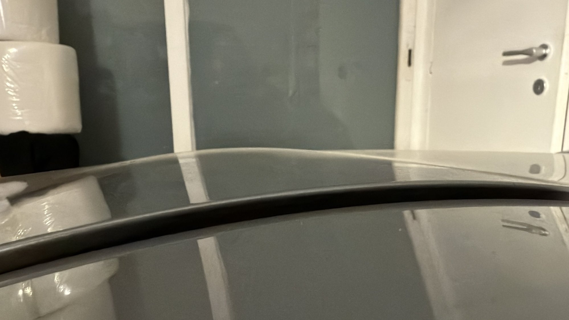

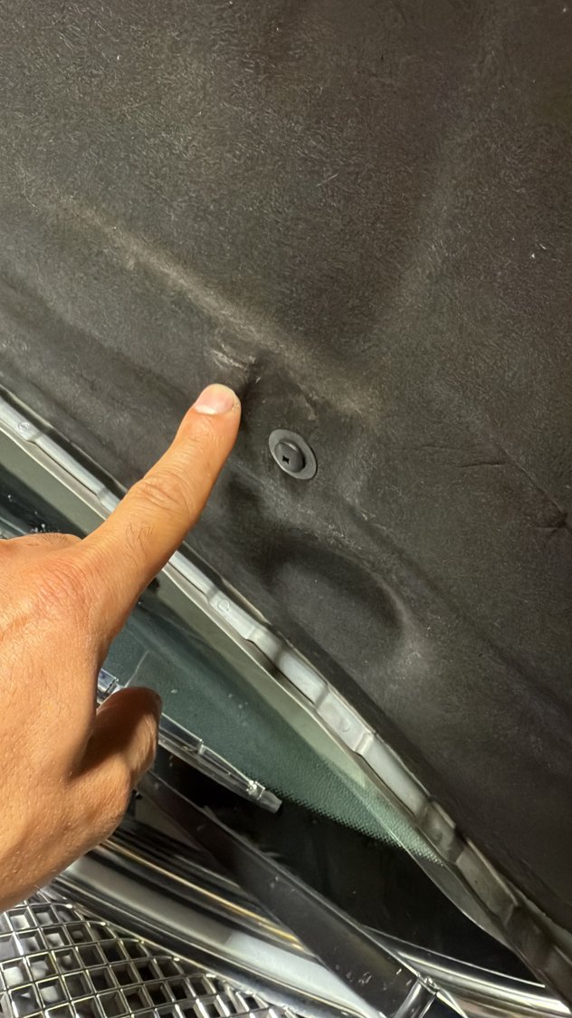

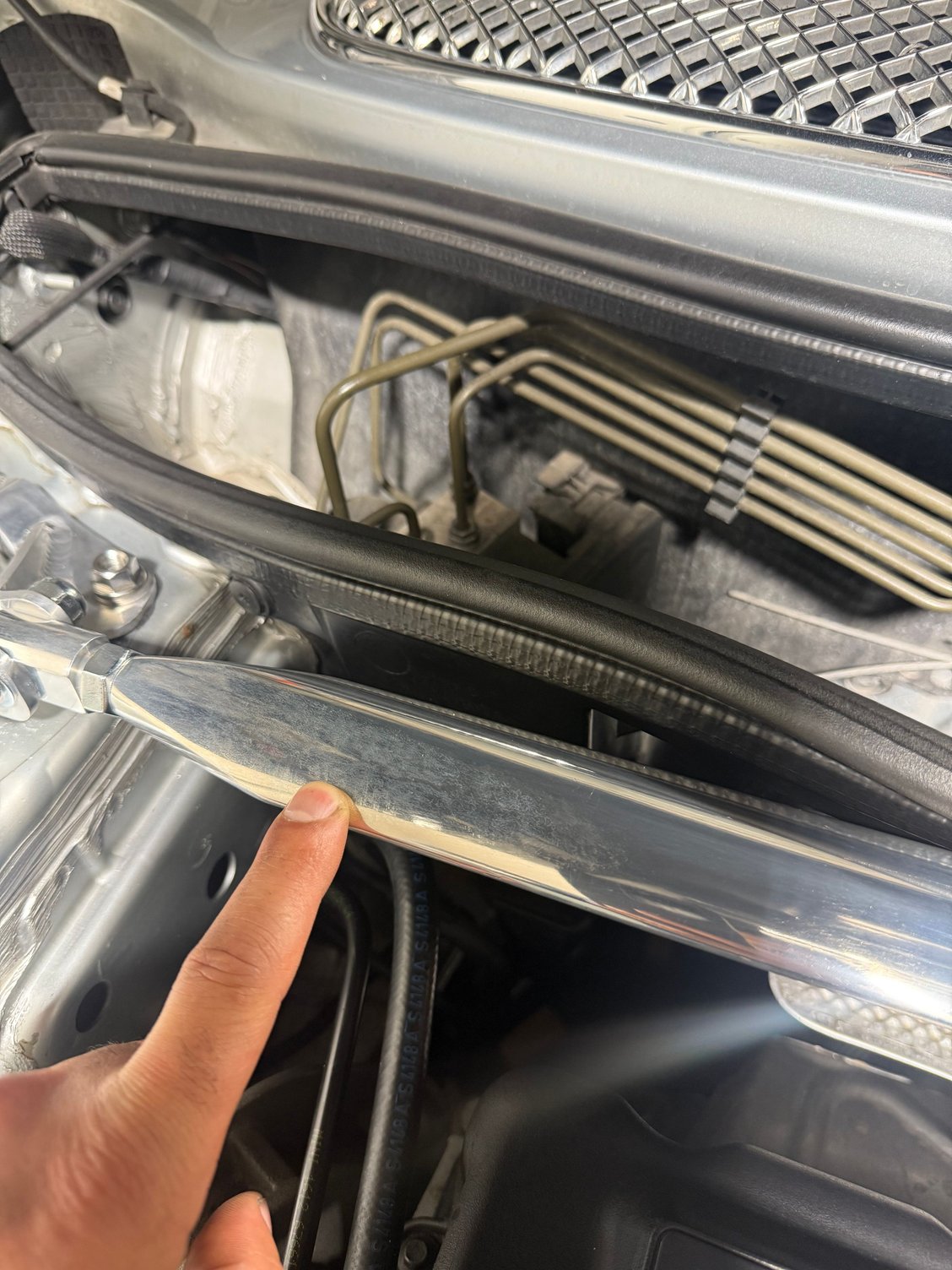

Hi, I bought an identical strut Brace like the genuine part and I have the problem to close the hood.
please, can you tell me a solution?
the hood is raised higher in the gap I indicate in the photo because it hits the bar from below
see the pictures attached
Old Jul 30, 2025 | 08:43 AM
Posts: 36,762
Likes: 2,551
Like my M7 Speed brace you have to wet the hood insulation and let the hood close for a couple days in the heat. The insulation them forms around it. If that does not work, you trim back some of the insulation.
