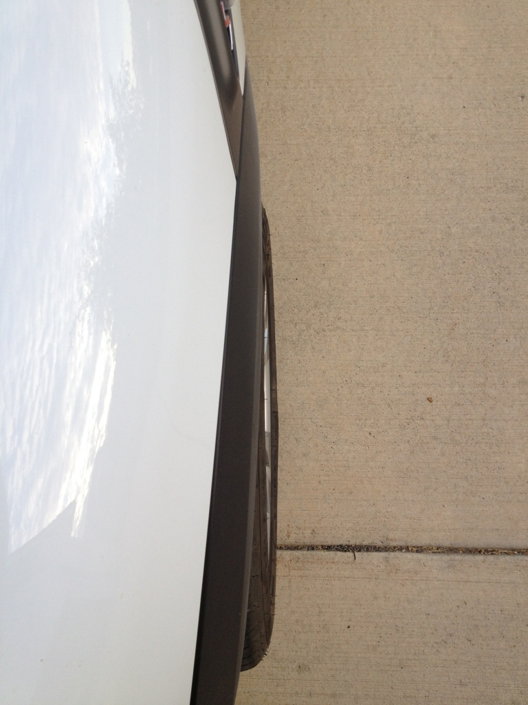

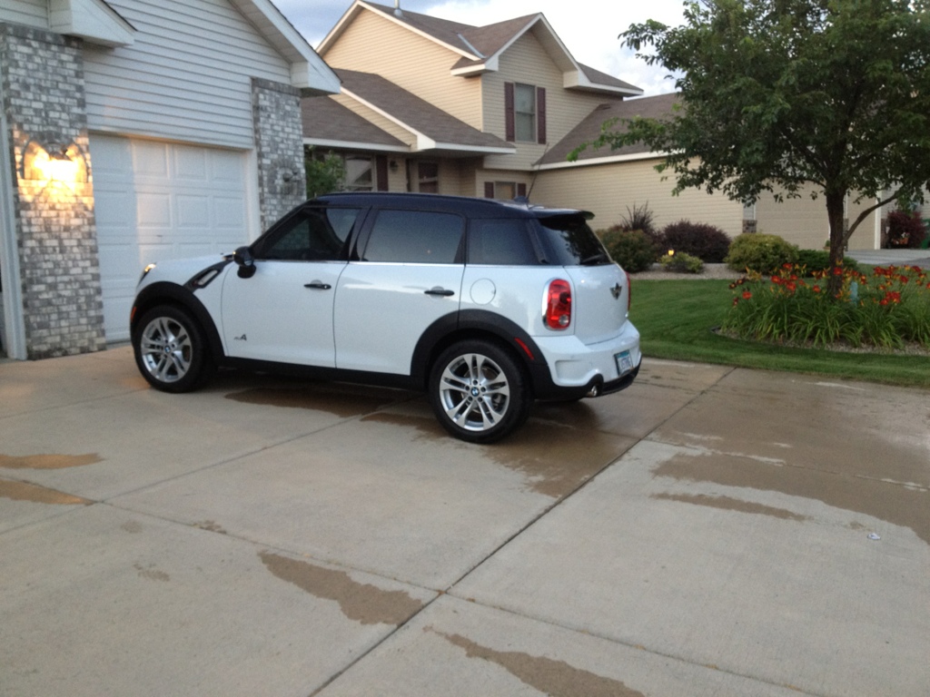

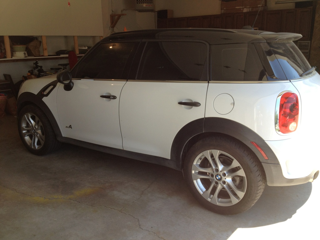

I just mounted my BMW wheels today 235/50/18's (wheels are 18x8 et46). I think the 50 series tire looks tough. Forgive the picture - it was a quick iPhone pic after I test fit the wheels before I decide whether or not to powder coat them. The only thing I'm worried about now is lowering it - maybe I won't...

What kind of tires are they? What's really surprising is that they don't appear to fill up the wheel wells as much as GeoffreyM's tires that are one size smaller. Compare the photos and I think you will see what I mean. Perhaps because your wheels are a different offset?
Old Jul 8, 2012 | 07:50 PM
liveSTRONG's Avatar
liveSTRONG
Joined: Feb 2006
Posts: 256
From: Minnesota
shark - the tires are Cooper's of course I didn't pick them out, nor do I really know anything about them...they just came with the wheels so I figured what the heck! Cooper Zeon RS3 is the full name.
GeoffreyM's wheel gap does appear to be smaller, but my guess would be that it has something to do with a combination of:
- the angle the pictures were taken
- the black wheels vs silver wheels
- the offset and wheel width: mine are 8" with a +46 offset vs his 7.5" with a +52 offset (I think) making his set in slightly and creating a little shadow
- mine may be stretched ever-so-slightly making the side walls a little shorter (I think 245 is standard over an 8" wide wheel, mine are 235's)
- possibly my springs haven't settled back in yet after jacking the car up to swap out the wheels

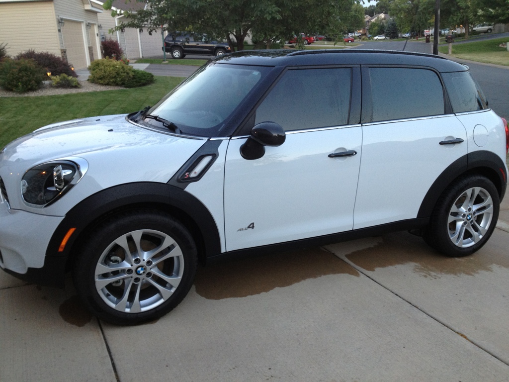

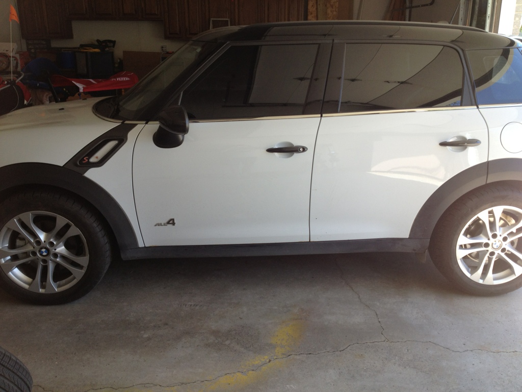

Here are a couple more pics after a late night bath. It looks a little 4x4ish, but I'm OK with that for now. I'm definitely leaning towards powder coating them black.
