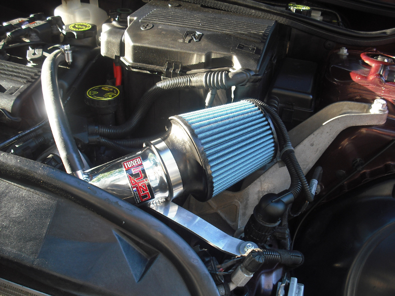

Just installed an Injen Technology Polished Short Ram Intake
I did this install 3 days ago. I've driven about 250 miles so far.
As for the performance difference, let me tell you that another hobby of mine is audio (Strictly 2 channel, no AV gear, thanks). And one measure of performance change in both these hobbies is "is there enough of a difference that the wife notice?" The answer with this intake upgrade is a certain "no".
If there is a performance difference, it's so subtle that it's negligible from a subjective standpoint. (Which should not be confused with "nonexistent"; I'm pretty sure there's a slight improvement in throttle response). It does however look cool and sounds pretty cool at and over 4,ooo rpm.
The car, BTW, is a 2003 R50 (production date of 11/2002) which I have had for about 4 years and have put about 67k miles on it (up to 112k now).
There were some frustrations getting it installed. It was not made with a perfect fit.
Attached Thumbnails Just installed an Injen Technology Polished Short Ram Intake-dscf1235-new-out-of-box-01.jpg   Just installed an Injen Technology Polished Short Ram Intake-dscf1301-intake-done-4.jpg   Just installed an Injen Technology Polished Short Ram Intake-dscf1235-intake-before-201.jpg

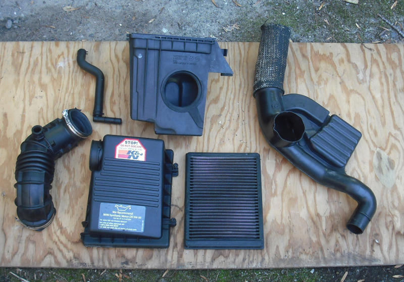

What came out:
and what went in:
Attached Thumbnails Just installed an Injen Technology Polished Short Ram Intake-dscf1235-intake-out-wit-hthe-old-44-202.jpg   Just installed an Injen Technology Polished Short Ram Intake-june-2013.jpg

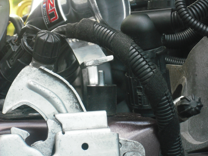

So, to the problems I had with the install.
Although my frustration level got a bit elevated during the install, once i figured out a couple things, the issues turned out to be minor.
Following the instructions (I know, my first mistake, right?), I found it did not fit the car as they said it would.
The instructions say to install the rubber mouth on the throttle body first, then install the polished pipe on next. Then they say to tweak its position until it "fits correctly".
Well, no amount of tweaking was going to get the pipe's mounting strut to reach the supplied vibra-mount. This is as close as I could get it:
I could push it down over this little bolt, but it flexed the throttle body housing in the process. I was not going to go with the "if it doesn't fit, force it" remedy.
First I thought to myself that maybe it didn't need to be tethered here, but that was not an option as it was in the way of the hood closing in this position.
To make the story a little less long, what worked was to go back and loosen the clams on the rubber throttle body transition mouth, tighten the mounting strut down onto the vibra-mount, then go back and tighten the clamps at the throttle body.
Simple. Like I said. And avoidable if the instructions had said to do it this way.
Attached Thumbnails Just installed an Injen Technology Polished Short Ram Intake-dscf1235-intake-during-not-quite-reaching-202.jpg   Just installed an Injen Technology Polished Short Ram Intake-dscf1301-intake-strut-high.jpg

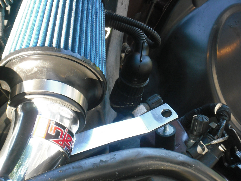

The other issue was with the oil breather tube. First, it's bigger than the stock tube, so does not fit the valve cover port without a hose clamp (not supplied, not mentioned)
The new tube is the orange-lined one:
Secondly, it is about an inch too short. I tightened the hose clamp on the valve cover end which allows it to stress a bit to reach the intake. (which it fits w/o a clamp). This allowed me to split the difference in it's shortness between the two pipes.

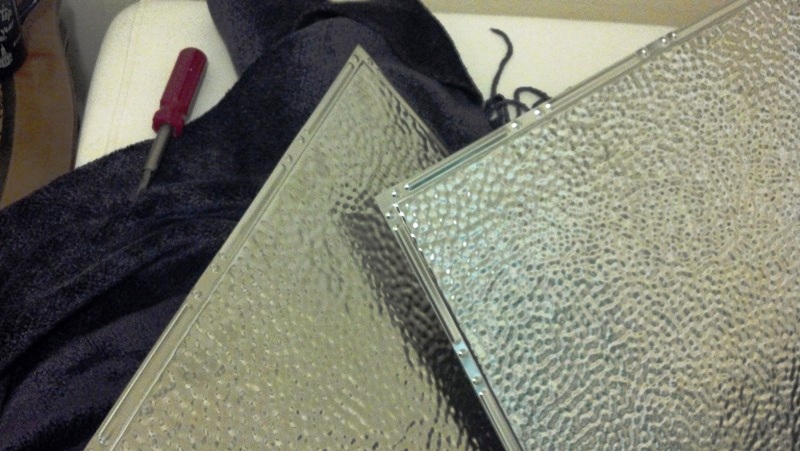

Thanks for the kind words. i saw your thread on your intake upgrade and it was very inspiring.
I am thinking about a heat shield. I will try a mock-up made from cardboard then see if I can get some metal to take the required shape.
I have a couple 24"x24" tin ceiling panels left over from a recent project as well as an old stainless steel hotel pan lid. But I think that might be too thick to shape without metal-shaping tools.
I'll take pics and post them here is I do any of that.

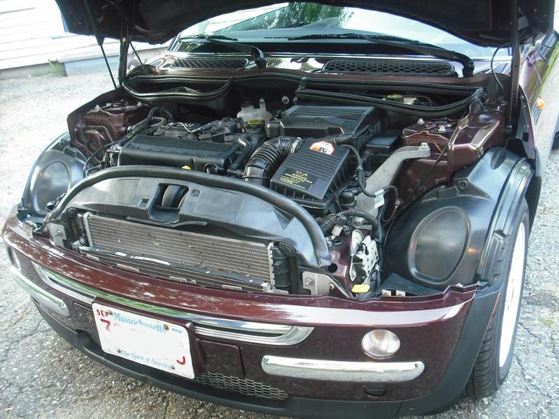

Originally Posted by Mynewt
What came out:
I'd really love to know how you removed the intake resonator (part on the far right). I tried to pry mine free, gave up after several hours, and sawed it off. I'm really jealous of how yours is removed so cleanly; I still have half of mine sitting underneath the CAI. Seriously if I knew how to do it, I'd go back in there and remove it right now.
I was just lucky I guess. To tell you the truth, when i started pulling, I had no idea the pipe extended down as far as it did; I thought it just entered the air box.
I think it was not attached to the resonator box inside the bumper. That piece is still in the car BTW.
As i wrote earlier, the whole factory air box system was in shambles and needed to be replaced. I know the nose has been off this car a few times. I've had work done to it that requited it be put into "service 2 position" (nose off) more than once. "

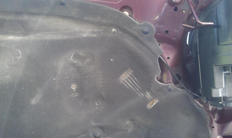

Old Aug 10, 2013 | 06:48 PM
Mynewt's Avatar
Mynewt
Joined: Jun 2010
Posts: 271
From: Mass-North Quabbin
You can see in this shot where the breather hose is worn light from scuffing on the inside of the hood liner. Also, the filter is grayed with the fibers of the hood liner which it's been wearing into for the past 3 months.
There's not necessarily any problem with any of this. I just think it's notable.
Attached Thumbnails Just installed an Injen Technology Polished Short Ram Intake-wear-pattern-01.jpg   Just installed an Injen Technology Polished Short Ram Intake-wear-pattern-02.jpg   Just installed an Injen Technology Polished Short Ram Intake-wear-pattern-03.jpg
