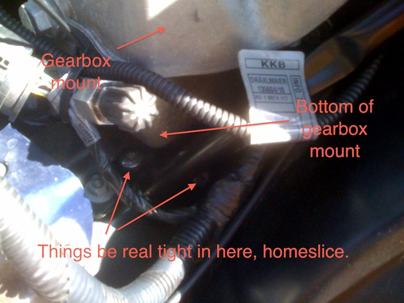

Hi all,
I put on front Cabrio braces on my MINI justa the other day and I hadn't seen anyone note this. The driver's side brace is a real trial to install due to limited clearance underneath the gearbox mount. See picture for details. The Cooper S people don't need to worry about this clearance because their cars are setup differently.
Hope this gets the word out there! It can be done though after much cussing!

That's strange, I don't remember seeing any clearance issues on the last R50 I took a look at. Do you have a manual or automatic trans?

Manual, 06. The later part of the previous statement might be where the issue comes from. The Getrag- R50s had a few things redesigned for the larger gearbox...

It was a simple install on mine....easy....are your towers mushroomed/deformed? The area is tight...I did unmount the AC line anchor, mount the brace, then remount it...but it only took an extra 5 minutes.
