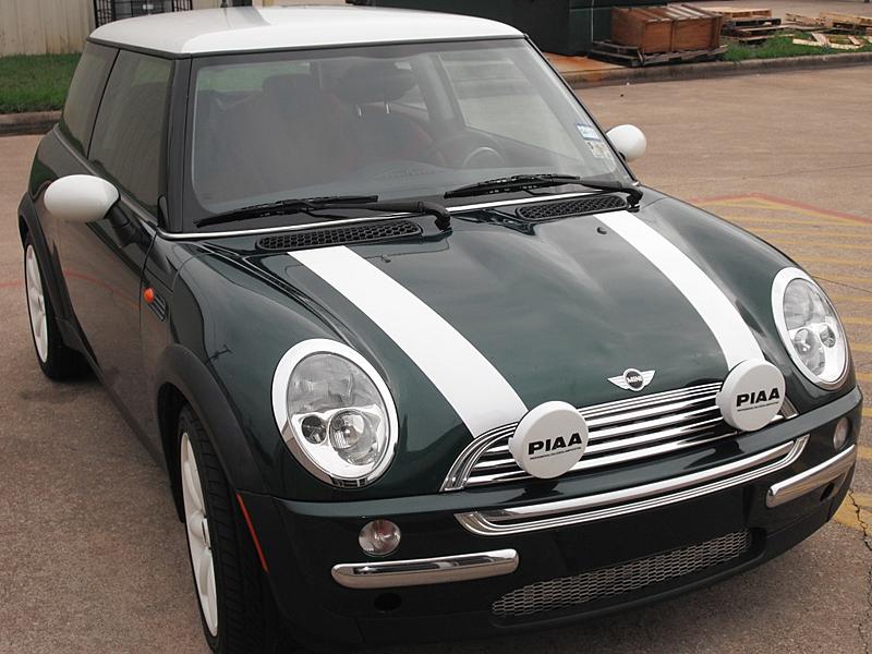

Hi Steve
I've put about 3K miles on the little FrankenMini since it went back together. In short order, I went back to mostly stock stuff like the cam, the exhaust, the header and the intake filter. While the modded version ran like a spotted-assed ape, it was noisy and pipey. The bottom end was "soggy" feeling until 4,000-4,500rpm, then it went off like a WRC rally car. With it's early Getrag 6 speed (tall 1st & 2nd gear), plus an aluminum flywheel, the car is touchy from a stop - even in mostly stock form. Not bad, totally happy it has a 6 speed, but everybody is right when they say "get the late model 6 speed". Some days I think I'll sell it and find a super clean R53 JCW and other days I like the great gas mileage of my R50. All in all, I'm enjoying my Mini.
Attached Thumbnails MCS crank/rods in a Cooper?-final1.jpg
