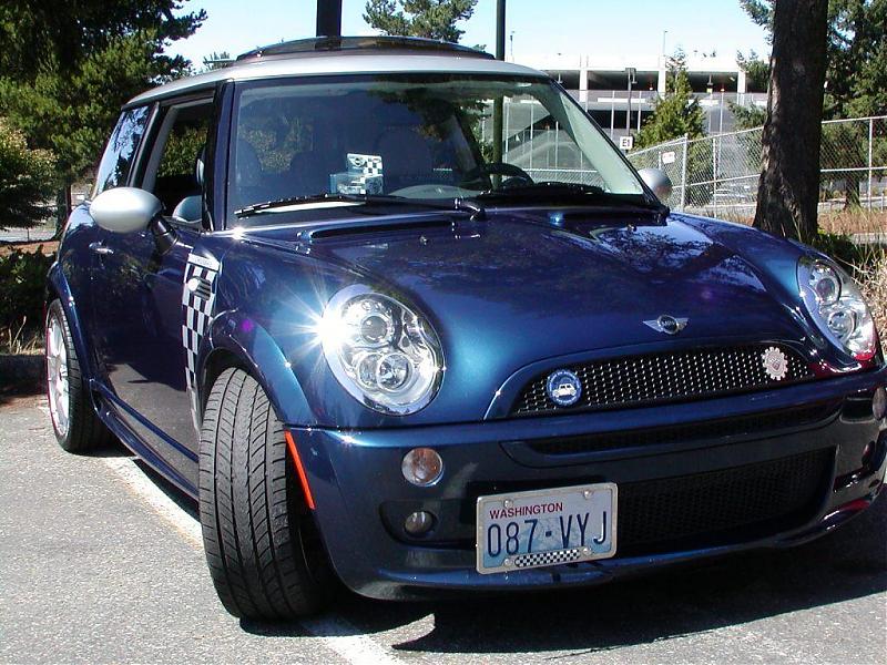

As an owner of an '06 Cooper CVT who has modded the heck out of I'll tell you what I have learned. 1st-your not going to squeeze a lot more horsepower out of a Cooper so enhance its strengths. Add a sway bar and springs to improve the handling. Then look to upgrade the brakes with better pads with less dust, and consider new slotted rotors or a big brake kit on the front brakes. 2nd-you can squeeze that little extra horsepower out with a CAI, ECU remap and exhaust, but the ECU may run you into issues with your warranty down the road. Additional mods like a new cam can get you closer to that threshold of pain for a CVT. 3rd-new wheels and tires can save you considerable weight that translates into HP. Go to www.wheelweights.net to see the weights of different wheels you are considering. 4th-other performance mods won't give you the same bang for the buck. Finally-modding the appearance of a Cooper is every bit as fun as modding a S. Here's a picture of my modded MCa after 10 months.

Nice car it looks good and you are one of the few who has a wind deflector. Since I now own a CVT I will only be modding it with a intake, exhaust, rear sway bar, with several mods to the looks.
