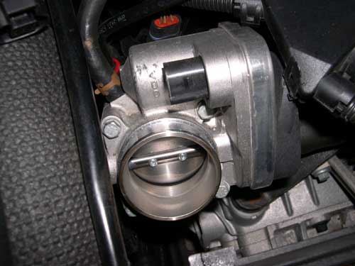

Hello everybody, I'm new to this forum. I'm from Italy, so I'm sorry if my english is not very good...
I'm installing an intake on my 2002 mini cooper (non S). I've chosen a universal BMC filter. I know it wont fit easily, but its so cheaper...
I've read and followed the instructions by OctaneGuy: http://www.littlemini.us/technical/intake/index.asp
The question is: AFTER I've removed the air box from throttle body, and BEFORE installing the new intake, i've turned on the car key just to extract a cd from the car cd reader, and discovered the car wont start and wont let me access to the navigator, radio and so on. I thought it was because I had disconnected the plastic connector, so I re-connected it, but nothing changes, the car is still stuck there.
I noticed that when I turn on/off the key, the Throttle body (the part in the picture) seems to move and make a sound.
Please tell me I've not messed up everything!!!
How can I fix that?
Thank you for reading!

Does the engine turn over? If not perhaps it's the battery. Double check and see if any other connectors have been bumped loose.

There's a connector just to right of the old air box. you probably remember It was actually clipped or atached to the airbox before the box before you removed it. I'd double check that connection. Not sure what its for but I'd be willing to be if its loose; its likely your promblem given its proximity to the air box.

You 've disconnect the electronic cable at the throttle body. This cable gives the sign of the gas pedal to the electric motor in the throttle body. You have tried to start the engine when the connector was disconnected. Stupidly!
I don't see the point why you have disconnected this connector?! It isn't necessary to do this when you install a CAI. I disconnected twice because of changing the TB himself.

i know on Nissans that if the electronic throttle is disconnected and key is switched on the car wont start and will set a fault, not always kick on the engine light though. if that happens then you have to cycle the key (~10 sec on, ~5 sec off, repeat) and that allows the computer to test both the throttle and the accelerator pedal to see if they respond. We have to do it at our shop every once and awhile.

Problem Solved!
It took me some time but finally i fixed that!!
First of all thank you to everyone who answered me!
Now if anyone can find this useful, I'll describe what I did:
1- Yesterday I checked all connectors, they were actually connected.
2- Finished installing the new intake.
3- I connected the battery to another car battery. The navi came back to life, but still I couldn't start the engine. Btw the problem turned out to be the battery.
4- Left the battery in charge for the whole night and this morning everything worked fine!
Actually I was just unlucky that the battery completely discharged exactly in those 30 mins I disconnected the air box. I dont think its because I did something wrong, it just happened in the wrong moment. Phew!
