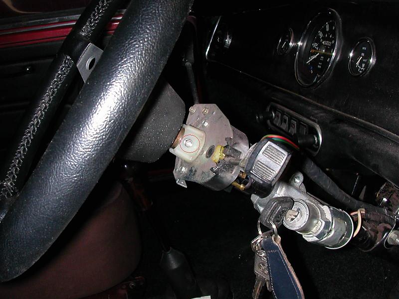

The cam was intact. Basically, its a sleeve that rides on the steering column. It has a key on the wheel side that presumably fits into the bottom of a factory wheel. My Mountey has no such matching fitting, so the sleeve did not turn when the wheel did. The solution was to drill a small hole through the sleeve and into the steering column, then insert a self tapping screw. The tripper that engages the turn stalk must be positioned opposite the stalk before the hole is drilled. See the attached pix, the nylon piece is the actuator sleeve. The added screw is circled in red.
FWIW.

STLMIni, does it do that in either direction? I haven't driven mine since I fixed it, so mine may do the same thing. But I did try it sitting still (which I'm sure was wonderful on the rack ) and it seemed to act properly. The tripper is opposite the turn stalk, so it only takes a half wheel turn or so to 'set' the tripper - get it around to the stalk side so that when the wheel returns, the tripper can trip the little nylon stalk lever. Point being - maybe your tripper has slipped on the steering column so that it takes more of a turn in one direction than the other.

Correction on my positioning of the turn signal tripper. I drove the car the other day and quickly realized that you had to do about a 180 turn for the tripper to return the stalk to center/off. So yesterday I swung the tripper around to the side of the column that the stalk is on, aligning it with the center line of the stalk and that fixed the problem. Same solution - drill a hole thru the nylon sleeve into the column, but drill when the tripper is on the on the stalk side!
