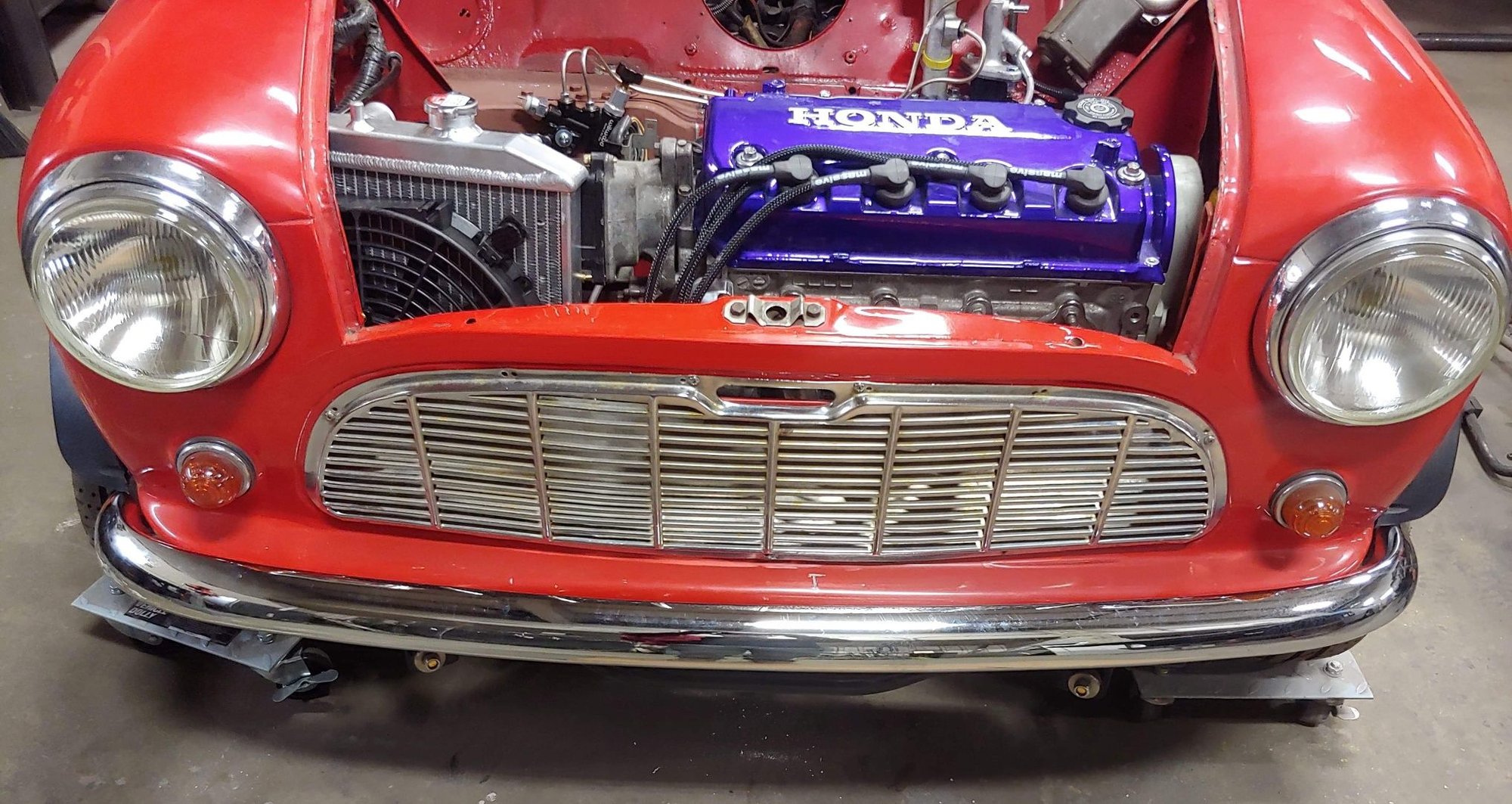

I live in Sausalito, CA, and wanted to share a project I am working on. I own a 2008 Cooper S convertible, and soon to be in my hands, a 1964 Austin Mini Pickup -- but not a normal one
I want to introduce the work that McGee's Custom Minis (MCM) has been doing for me. I am taking a 1964 pickup and lightly modding it with his subframe and a D16 engine w/minimal cutting of anything important.
So far the specs include (among many other things....)
1964 Austin Mini (SA model with roll up windows)
Stock cone suspension all around (no coil overs)
D16 with medium built engine (Crower cam stage 4, Crower valve springs/retainers, Blox cam gear, ZC pistons NPR, King Race bearings, OEM gaskets, Contitech timing belt/waterpump, ARP headstuds)
MCM custom subframe (allows for standard suspension, no odd placement of wheels/clearances so you can buy stuff that works on a mini, not for the subframe)
Tranny mods, e.g. LSD, 3.7 FD, etc.
Skunk 2 intake (MCM modified and Skunk2 TB)
Hondata S300 ECU
Fully adjustable suspension pieces all around
Minisport 7.5" 4 pot alloy brakes to work on 10's
LHD conversion
Upgraded master w/bias valve
Wireworx wiring harness
Custom exhaust
Modified shifter
...and a bunch of other shiny bits (basically all new underneath?)
My contribution will be:
Base tune plus dragging to dyno
Momo steering wheel with remote 8 button wireless steering wheel controller (no buttons on dash ).
long drop link for steering column (not the cheap chrome one)
Race seats and harnesses (who knows if they will fit? Anyone????) Thinking inexpensive Cobra Monacos (anyone fit any to a pup????)
custom Dash and lots guages
All finishing wiring
Upgraded adjustable shocks
Headlight 'eyelashes'
Windshield wiper 'washers' -- they were shaved by PO
Mirrors (also shaved by PO)
Front bumper? maybe MCM will help -- lip shaved by PO
Trailer hitch
Rear bumperettes (maybe....kind of like it without them)
New dash cover, door cards, headliner, etc. ... eventually all pretty good right now
Hopefully, as I have not seen it in person, full of rust, so I assume I won't have to do much body work lol
etc. etc.
This is a lot of work overall and MCM text's/calls several times a week to keep me informed, so huge customer focus on his part. Pics on FB can be seen here: https://www.facebook.com/media/set/?...5111049&type=3
But in general, MCM has delivered this pretty quick. It has only been over there (I bought the base truck from him) for a few months....but now I am getting anxious lol.
More to come, hope to have it in a few weeks

Subscribed to that forum...looks to be pretty friendly! Some pics below....getting close!

Almost!
pretty dusty and ride height needs adjusting...
engine, radiator, etc. all in. When it gets to me I will install the 3rd party race loom and gauges, heads up display, removable steering wheel, seats, harnesses, etc.
