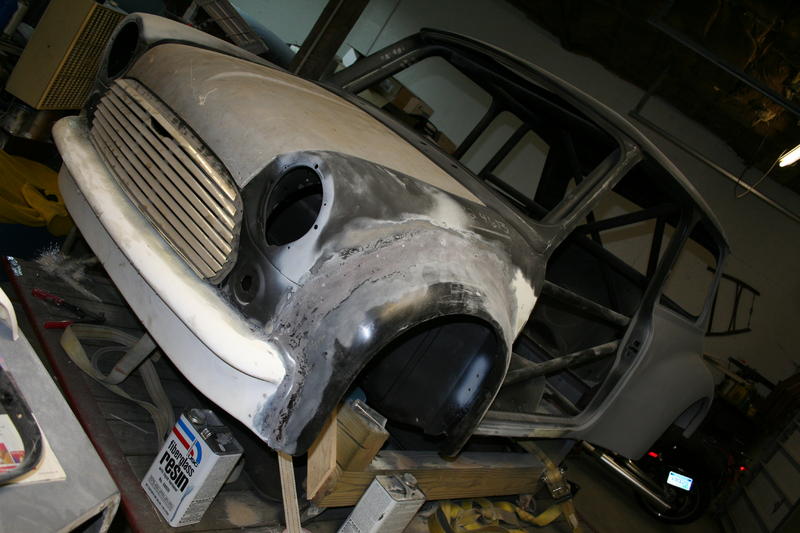

Here are a few more pictures of the project. Hopefully this weekend I should be able to weld up the roof and finish up the passenger side rear flare.

Question, when you cut the inner fender...is there something you line the inside with? I just cant imagine having to clean the thing every 3 days of driving since there's no fender liner.

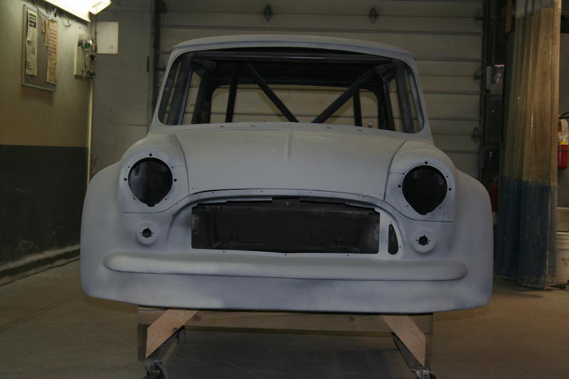

Here's some updated pictures of whats so far been accomplished. Roof has been filled and the body work just needs to be blocked a few more times before its ready for paint. Started accumulating more parts to finish building the motor. College student and projects don't mix very well but its getting done slowly but surely. Thanks for the interest everybody!
TooFPaste39
-In some parts were gonna fabricate something to prevent anything from building up definitely around the door hinge bolts in the a pillars. Then cover most of the inner fenders and bottom of the car with a SEM product that will prevent stone chips and anything else.
