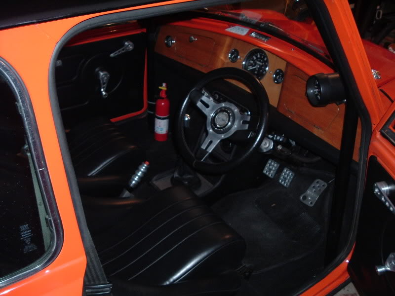

the big fender flares you see on later cars are bolt on parts easy to remove change. My car is a 79 MK4 but as you see has been 'retro'd' with many MK1 bits and pieces inside and out .... easy to do (depending on your skill level) some just bolt in some require some body work (like cutting out later tail lite mounts and welding in readily available Mk1 mounts) .. some like changing later internal door hinges to MK1 external hinges are a bit more involved but doable. MiniWorld regularly runs features on doing mods like this . . .
