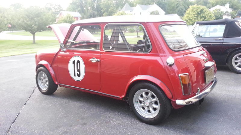

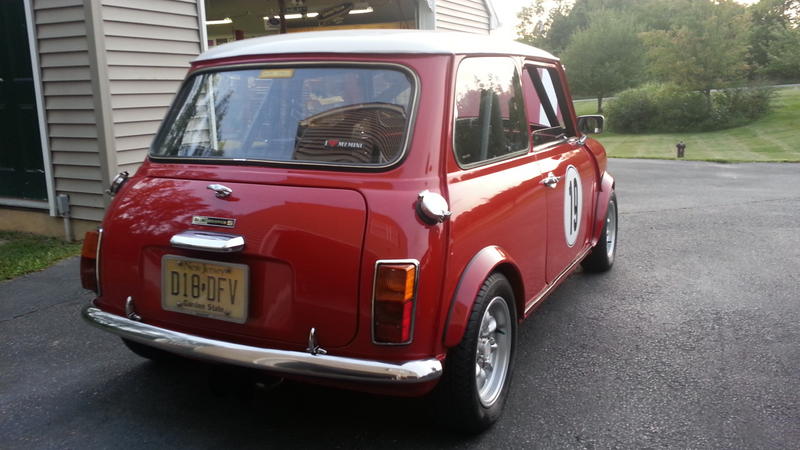

Claims it is a 1971 Mini Cooper S. It has a right-hand drive, the older style 2-color tail lights and the door hinges are inside the door.
But it also has 2 gas fills on the rear, which I don't see any information on why it has this or what Mk designation it is unique to.
Just need some help and it does present a buying opportunity if it is unique.

I asked a friend of mine about this and here is his response.
"1971 could be a MK III cooper S. Twin fuel tanks means it is a S in those years. The engine and gearbox -- does the gearbox have rods to change gears then it doesn't have the original engine. Do you have some interior photo's of the car?"

MiniMania used to have a great "model year" descriptor with most variations.
Visually, it looks pretty Mark III ish......the second tank could have been added. so engine /gearbox will help. it could have started as standard and been modified to S....
998 engine for standard, 1275 for S . . . there are identifying numbers in the engine bay that will help. Check MiniMania

arches, wheels and headrests all suggest a later car that's a re-vin

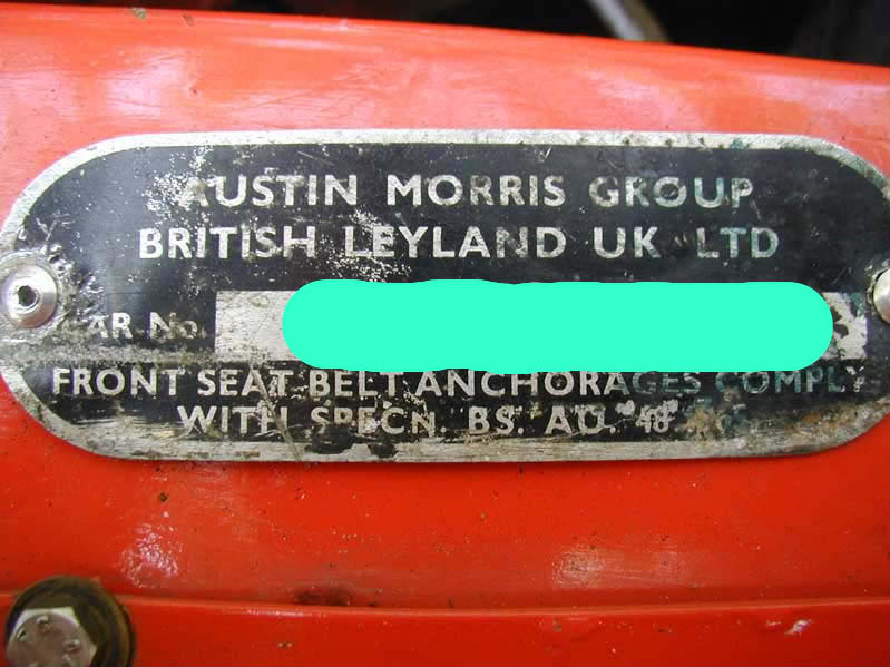

start easy - does your VIN plate say who made it?

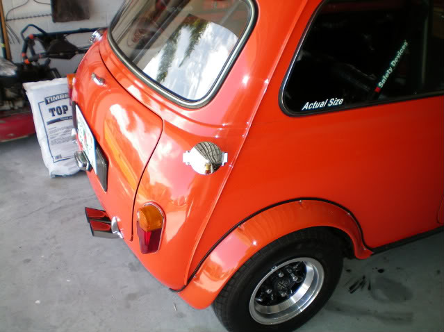

second tank is easy to add - not all that unusual if heading for the rally look as suggested by the roll cage. btw IS there a second tank or just a filler? fake filler for Cooper look is a few dollars (ask how I know)

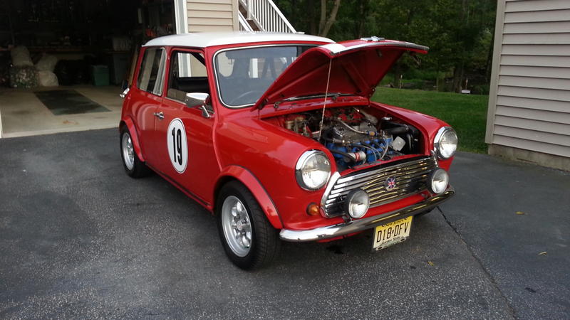

none of this is a deal breaker if you like the car - and the price - but it IS wise to know what you are buying as sometimes there ARE parts differences. Again ... ask how I know?@#$%? Here's a biggie: does it have a A or an A+ block? 71 will be A unless re-engined. That valve cover suggests A+. Two quick checks.

I see what appears to be a fuel line to something that does not look anything like an SU carb (or carbs) .. is it a Weber? Pic of engine is needed.

but decoding the VIN only helps if there is some confidence the VIN is correct in the first place. Otherwise it tells you about the car the VIN was taken from!

I don't think the engine is stock anyway.

there are a few ways to tell if its a real S.....take a look at the back of engine If its an S block there should be an ally plate with 1275 stamped on fitted to the block... cylinder head will have 10 nuts and one bolt at thermstat end..the dizzy would have no vacum advance....should have 10" disc brake set up...a 130mph speedo dial......

Highly unlikely that it's a 1971 Cooper S. Body is most likely a MK IV or V because of missing drip rail along roof gutter. Appears to have split-brake master cylinder which is post-MKIII. Quick glance on viewing video doesn't show evidence of hydro suspension.

1971 Mini Cooper S has twin tanks and is classified as Mk3. As said the lack of roof gutter side drip rails means this is a later Mk4 bodyshell and will have the rod gearbox tunnel rather than earlier remote.
It could be a genuine Mk3 S re-shelled but more likely a re-VIN. OK at the right price for what it is if you like it.
