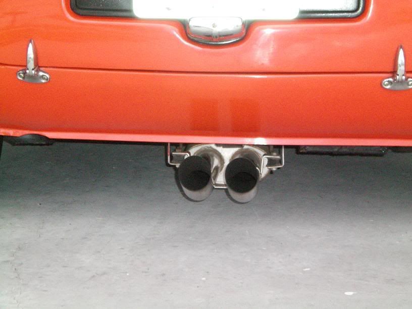

However wrt the fumes and boot question, your logic is good, however I have a big twin DTM centre exhaust
and I don't get any exhaust smell (or I'm always drowsey from the fumes) even with the rear windows open. Maybe I'm going too fast for them to catch up, but I doubt it.
But IF you suspect a poor boot lid seal consider removing the seal that attaches to the boot lid and using the newer boot seal that attaches to the lip of the boot opening; that is IF you have the older type (pre 1988)
When I rebuilt my boot lid - which is a MK1 lid btw - I tried several times to get that darn seal to attach properly, but all those little clips and the bends it makes - argh - after three tries (that's sets of clips and lengths of rubber) I tossed everything in the trash, sealed the holes for the clips and used the newer seal. It took 2 minutes to fit it and it seals better; better than a poor condition or poorly fitting original anyway.
